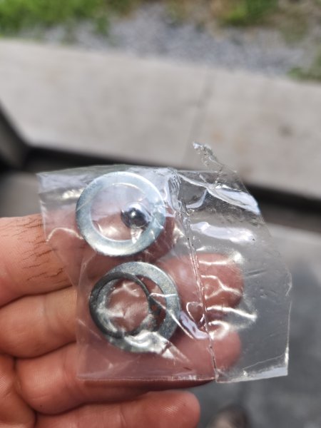

That bottom package with the small snap ring looks like it might be for the rear servo where shift kits place a thick spacer/shim to make it act like it is solid.
