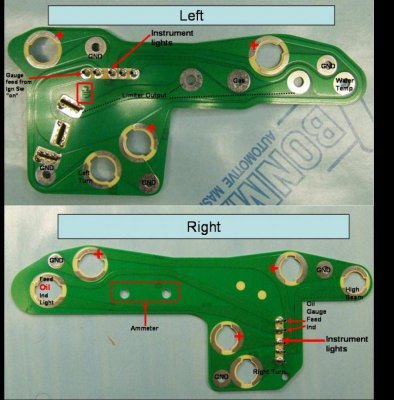

I was looking at the wiring diagram and pictures of the instrument cluster. The gauges that are not working are on the same printed circuit board. You didn't mention which lights were not working. The only problem is the right turn indicator is on the other board. All of the inputs are unique to their origin. This is going to sound crazy but is there a chance the two 5 pin connectors are switched? Try this, with the ignition on, turn on your bright lights. If the temp gauge pegs, they are reversed.
Small metal piece goes between dash cluster and dash, this is a must. I did actually run a separate ground from the back of the cluster to the firewall for good measure. Fought all the demons you are and am telling you they are ground issues. Emery the areas around where the cluster screws and the metal piece meet the dash (bottom of cluster). I did end up purchasing a circuit board on one side as the pins coming out of it were loose from age. Good Luck.

yes, then ran over to body, emery cloth a spot and used a self tapper. I would take the cluster out and use a meter to test all circuits for continuity. Easy to follow on back. You can also test bulbs at that point, again my pins were bad from disconnecting and age, not very stout, so be careful when unplugging. Have fun.

For extra ground you can use two wires to screw hole on each board that come together in a large hoop connector that you can attach to upper column mount/horn ground bolt on upper column mount bracket.
These are great boards made in Canada with stronger pins than original.
