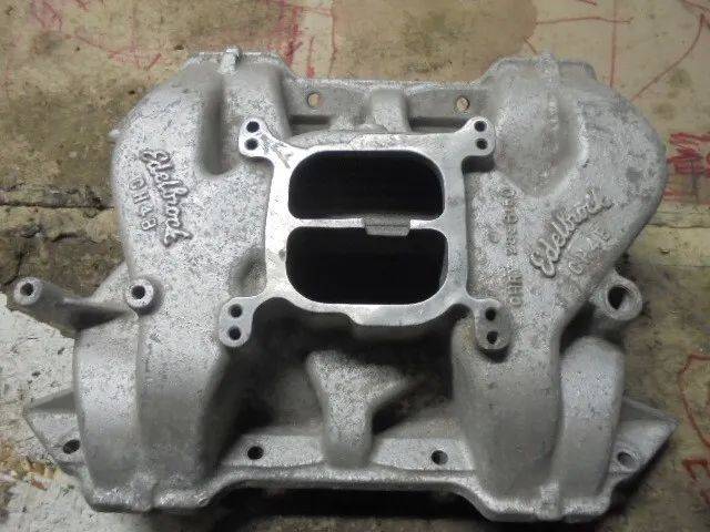

Edelbrock CH4b is basically an aluminum version of the stock cast intake. Here is a link to a thread here on FBBO with some great info on the CH4B.
LINK

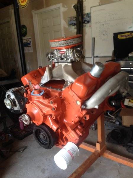

The RPM Performer is a great manifold. I got one to fit under a stock hood with a drop base air filter and thinner filter. For the heck if it, I also used a K&N open filtered top.
