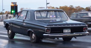

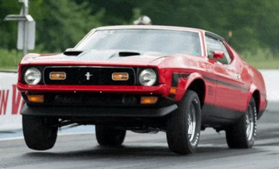

Now it makes a little "more sense" of why you don't want to use headers, they are against the rules for F.A.S.T. that is some important information you left out of your 1st thread... There is a guy who runs in the 9's (correction, he runs in the 10's actually) :headbang: with skinny "stock dimension street tires" {another F.A.S.T. rule} & factory appearing engine {outside any way} with a "stock sounding" idle {another F.A.S.T. rule, very loosely interpreted} & "stock appearing" cast iron exhaust manifolds {another F.A.S.T. rule}, a 69-1/2 A-12 RR in F.A.S.T. Mancini Racing's advertisement cover car...
Here are a few of the noteable F.A.S.T. guys, a 68 Hemi RR 9.98et @ 139mph, a 69.5 A12 10.81et, a 63 10.38et @ 133mph... The record holder is an ugly Mustang...LOL... 9.84et @ 132mph.... you better have your **** together to run with those guys & to run those numbers & iron manifold, on skinny tires... Factory Appearing Stock Tire... Good luck with your 66 Charger Project, Have Fun & Happy Moparing....
