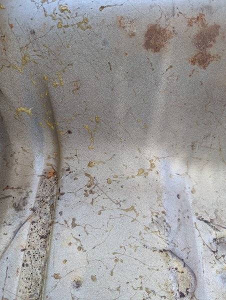

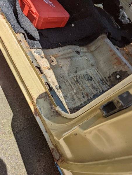

Was the interior bare metal painted the same color as the body from the factory? I'm not speaking of the areas that are visible like the upper door frame (mine is Alpine White in that case). I am referring to the floor pan for instance. I am treating some of the rust and will probably re seam seal and paint before adding fresh carpet and I noticed the paint is not the same as the exterior body color. The body color is Citron Mist but the interior looks more like a matte champagne (possibly metallic even). I'm not trying to create a perfect match. I am more curious than anything else.
Body-color overspray over the anti-corrosion dip.
Hmm...I feel I like I may have read that in another thread. So pretty much the paint that lands in there while they're painting the body? It seems like the coverage is better than just overspray and the texture doesn't seem as rough as I would expect either. I'm guessing most people don't care to replicate this and just spray it completely with body color, including the clear maybe? Thanks for the response.

As far as I know, this interior is original but seeing some other examples would be cool. Spraying whatever they have on hand makes sense. And thanks for clearing up the overspray bit. Based on what I was thinking, that didn't seem to be the case.
