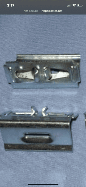

I just realized I’m missing one and my windsheild is in. Can I install the missing one with windsheild or does it have to be pulled?
unless i'm mistaken you windshield can stay where it is, thats the clip to screw the a pillar interior trim piece correct?
you know how they function right, if that clip was installed once before you have to pinch the side that goes in the hole so it can be installed , once in pinch the opposite side to spread the tongs in the hole
I appreciate the info. I’m f
Going to buy new from RT specialties
