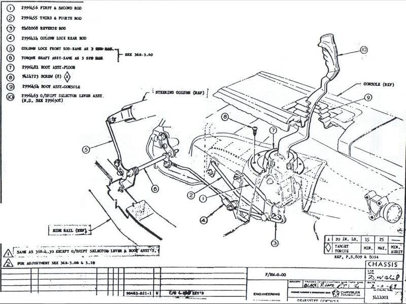

69 charger 4sp. I am getting a lot of engine/exhaust heat coming up thru the shifter boot. Haven't pulled out the console yet. Is there more than just the boot covering the hole?
there is 2 boots with a console car, one on floor and one for console.
Thanks for the diagram. I'll have to look for that other boot.
