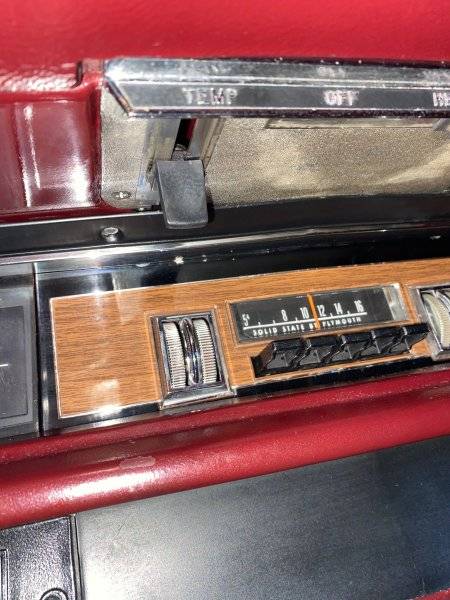

If you can't get it to stay in the OFF position then something is up with the cable IMHO. Also you should be able to regulate the temp. If it's just a blast furnace all the time, again, something wrong there.
The right slider is the fan switch
The slider on the left is for hot and cold temp. Move it to cold and you should be there.
off/heat/def is the selector for where the air comes out.
heat is the floor and the other 2 explain themselves.
if either of these two are not working right then you need to troubleshoot it. cables bound up, or there could be an obstruction inside the heater box not letting it move through the full travel.
Also the control panel sliders could be binding up, but not common.

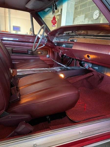

Nice 4 speed GTX with burgundy interior!

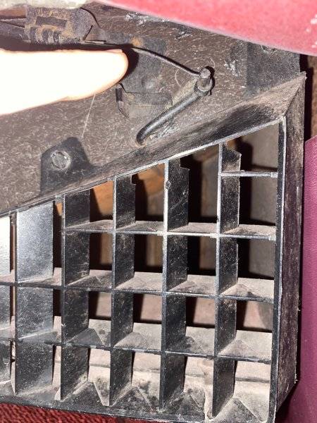

If you mean this, its closed
That is the vent control, has virtually nothing to do with heat control. its simply there to draw air from the interior or thru the cowl vent

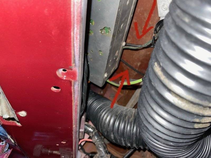

The heater ( aka blend air ) air door is on top of the box and to the right of the blower motor resistor
If you cant control outlet temps you have either a frozen control cable or an obstruction inside the box
