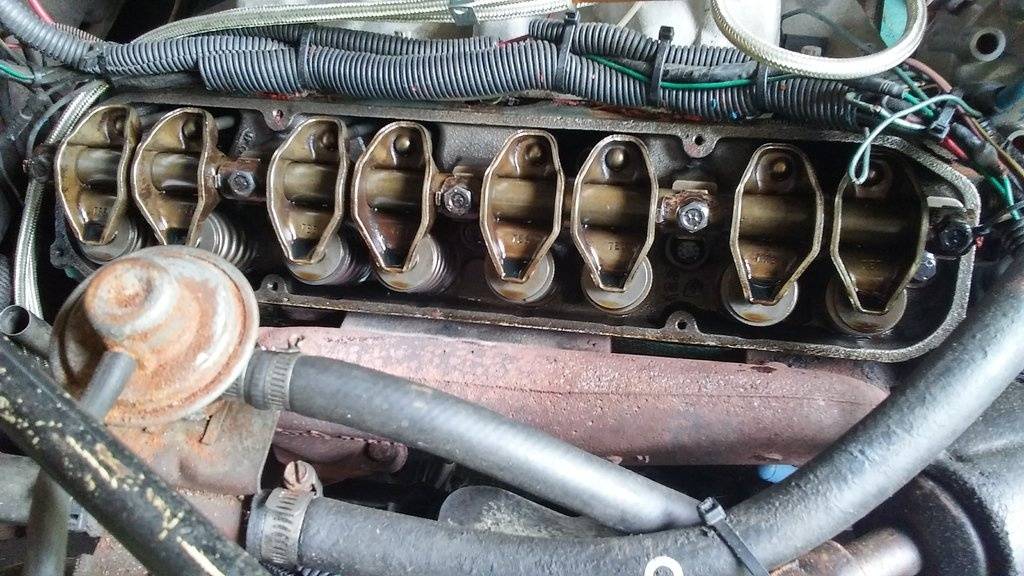

....or what sounds like valve tap. Last year I had to install new lifters and cam as one of the lifters on #6 collapsed. The engine would make that oh so familiar tap, tap, tap sound before I did the swap. Once I finished that it was all quiet again.
Now a few weeks ago coming home from a car show I started hearing that sound again, but it comes and goes...not steady with engine rpms...and it goes away completely when idling. I pulled the valve cover on that side to check the rocker arms...(with a collapsed lifter one can actually rock or move the lifter arm with fingers a tiny bit...that's how I find the bad lifter the last time). This time all the arms are nice and tight...can't be moved at all.
So kinda baffled here....anyone care to take a guess? I can start the motor right now and all will sound normal. Yet after five or six mins on the road the tapping will come back.

View attachment 446032 ....or what sounds like valve tap. Last year I had to install new lifters and cam as one of the lifters on #6 collapsed. The engine would make that oh so familiar tap, tap, tap sound before I did the swap. Once I finished that it was all quiet again.

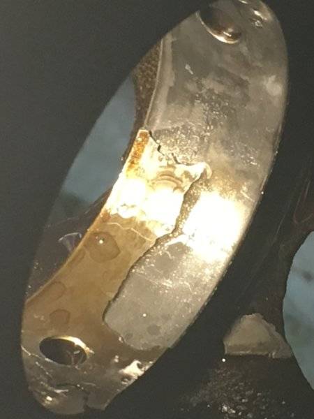

Be very careful with motor flushes. If you don't get it all out it will eat up your bearings like this.
