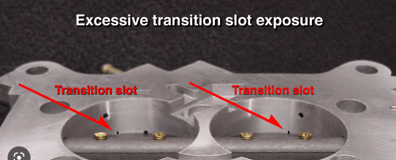

Do you happen to have a pic of what the transition slot looks like? I have the idle speed screw turn in only about a half turn and the mixture screws seem to do nothing
Since you said it is a fresh build i want to ask if the cam has had its break-in already or not?
If not you need to do that first, regardless of idle quality because idling and doing these adjustments are not good for the camshaft and tappets and can result in damaging them.
The transition slot looks like a fine vertical cut in the carb bore.
Only a small part of it should be exposed below the throttle plate, see below picture from the web i found as example, the exposure shown there is already too much.
As you describe that the idle mixture screws currently have no effect on engine idle i think you need to close the throttle a little at the time by the idle screw.
If there is too much exposure of the transition slot there is a lot of fuel being fed through it and causing it to run very rich.
Let the idle fall to 750-800 by closing the idle screw, after you can try opening/closing the idle mixture screws to find it needs more fuel or less.
Engine idle rpm will increase as you get close to the correct adjustment, i guess the current 1,5 turns you have at the moment is too much already so i would try closing them first a quarter turn at the time with the engine idling.
Have a vacuum gauge connected on the manifold port and use it as a guide, getting towards the right adjustment, the vacuum will increase.
Have the engine warmed up a bit before you start and give it a little time between adjustments to see what it does.
