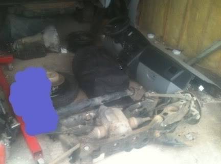

Parted out the charger today, now I've got the entire drivetrain for my belvedere.

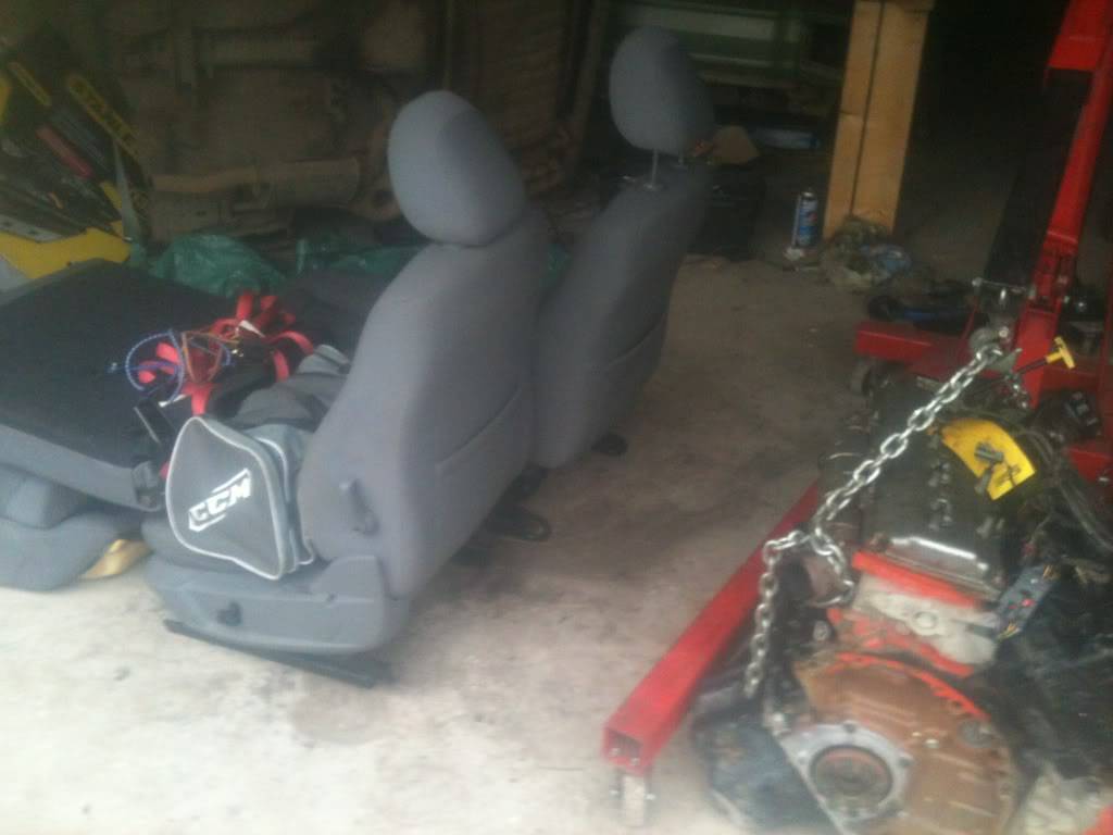

Also I have the complete wiring harness including the abs brake controls. I'm going to attempt to use the factory charger tranny control. That way hopefully I can just have a simple daily driver car
Ok, so you've been busy, my bad.lol! I think you are gonna need the wheel speed sensors for the nag1 trans to work right, may wanna check on that.
that black duffle bag has the complete harness from the 07 including all sensors :icon_biggrin:, the tranny controller and engine computer. We'll have to see how well one can adapt wheel sensors I might have the only 63 belvedere in existence with abs might be more out of necessity to make the transmission work properly. I should be able to use a diablo tuner in the belvedere to tune the factory computer.

sweet that sounds pretty cool, on a special not I'm only considering the abs if the tranny controller will require it. This car will just be a basic daily driver so it needs nothing terribly special. the 68 dart I have will be the real performer eventually.
