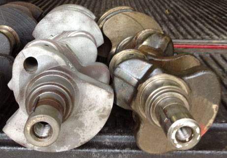

Just helping a guy find one, his 340 crank is cracked.
I believe the older 318s were forged?

Only 318-3 HD truck or industrial engines had steel cranks... that said I still havent seen one in the 30od years i have been messing with engines. but the cranks will physically interchange, maybe a poly crank? IDK
As I said i have yet to see a 318 with a steel crank.
Not all....last time to see a teen forged crank came out of a 67 engine.....
True that. There is a ton of "what if" information out there about 318 cranks. & 1's that were cast, 70's that were forged, up to 68, up to 70 not including 71, some 71's. I can't seem to find a definitive list anywhere. Small blocks switched to cast in 72. except for may be trucks. Who really knows. :BangHead::BangHead::BangHead:

Yes, but too light for a 340. You'll spend a fortune on mallory metal getting it balanced. Ask me how I know...
my 69 273 dart is also a forged steel crank.My 73 340 was cast, as was all 318 engines I came across beginning 1973.
318-3 truck cranks were all the rage back in the 70s and 80s. A very strong crankshaft. The crank had solid throughs where the rods sat. Strong but heavy!
You would have to use 273/318 rods and some real light pistons and pins.
I believe a 66-67 318 Poly Crank is Forged and will 'physically' interchange in the LA 340, however,
I seem to recall a problem with the T/Convertor hole size at the rear ?
and they are a far heavier Bobweight that will require Balancing ?

That would be interesting to find out. I bet those Poly pistons are pretty heavy though. The 273/318 cranks were basiclly the same. The 273's used heavy wrist pins to help the bobweight.

I bought a 1967 318 (build date 12/29/1966) the previous owner stated was pulled out of 1967 Coronet by his buddy, who was the second owner. Before I dropped it in my 68 Coronet wagon I changed the oil pan for a cleaner one and change the head gaskets. It has a forged crank and standard bore factory pistons.
