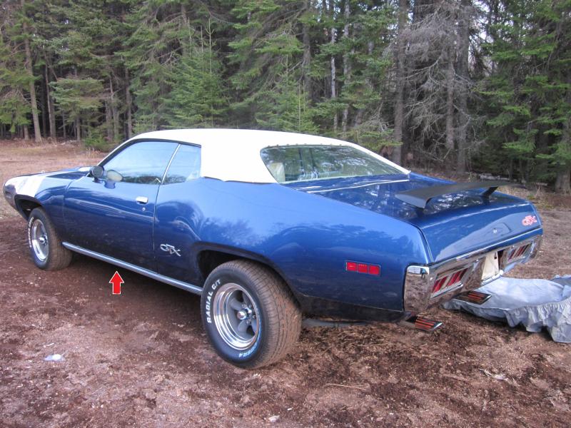

Hey there guys, I have a true 71 GTX. I'm super new not only to muscle cars, but to the forum also. I'm really hoping someone can help me out. On the GTX there is an aluminum "plate" that runs from behind the front fender to in front of the back fender on each side of the car. What are these called? and where can I find them. Also looking for input on this car, i'm putting it on the rotisserie this month. Going to sandblast the underside. I already removed all the old factory undercoating with a heat gun and scraper which was a fun job:headbang:. Anyhow the input I'm looking for, is what many seem to ask. Should I Undercoat it, or Paint it. Well, here are my plans for it. I am planning on having it a clean street/strip car. Go to cruise night and whatnot. this being said, the underside isn't perfect, well maybe not yet, someone installed a new floor pan into it and did a shitty job, hence the rotisserie. going to have to do some welding/ brazing. Also what are any thoughts on Tying the frame?? Thanks a bunch in advance. Just a young buck wanting to get this beauty on the road for next summer.

They are rocker moldings and for the 71 GTX are a one year and model only and can be pretty hard to find. Looks like the 70 Grand Coupe ones but are longer. Be prepared to pay around 200-300 for a set.
If i were you I'd check with 5.7 Hemi. He might be able to save the ones you have but will need some good pictures to see the da-mamage they have incurred I imagine.
