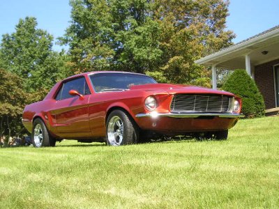

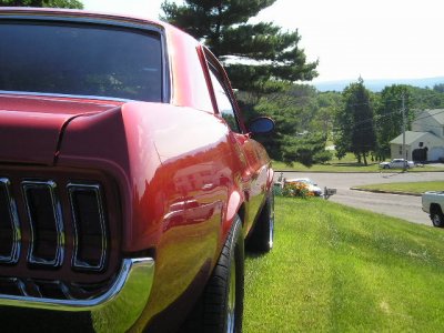

I built a '68 Mustang a few years back and the color was a copper pearlcoat but every picture of that car made it look red. If you saw the car in person, you'd never mistake it for red, but the camera shows what the camera shows. I would hit a few car shows, see the cars in person and ask how and with what they were painted. Yes, it's time consuming, but it's about the only way to be certain to eliminate the digital distortion.

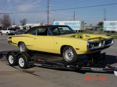

This is my 70 Bee, taken a few years ago. It's almost ready to "rumble" with the 70 Hemi.

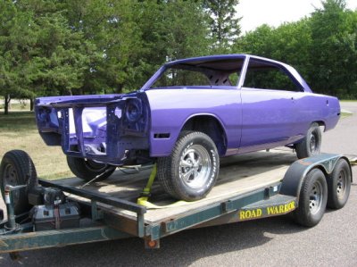

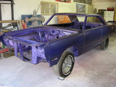

Whenever I restore an old car, my last coat of primer is pretty close to the color that I'm painting, for instance this Dart is Plum Crazy, so I add a purple toner to my primer. You have to be careful, because not all primers can do this.
Then when I seal it, it's pretty much the same color as the primer.
After the car is painted, if it gets a rock chip a year or two later, it's less noticeable.
What you put under your color and clear is very important.
