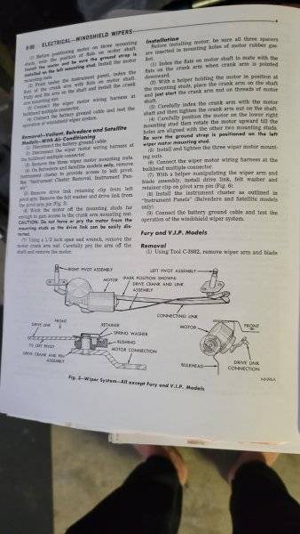

Is it possible to install the wiper linkage incorrectly?
Probably.
I found out my problem is i did not pay attention to the FSM. A little thing called indexing would have saved me a problem. The motor worked fine, until it did not. I bought the wiper motor some years ago from kim, passion4mopars. Not dissing her, but i cycled the wipers a handful of times, and the motor stopped working. Switch is fine, wires are correct in the connector : green, red, blue, and brown. 1967 B body, variable speed wipers.
