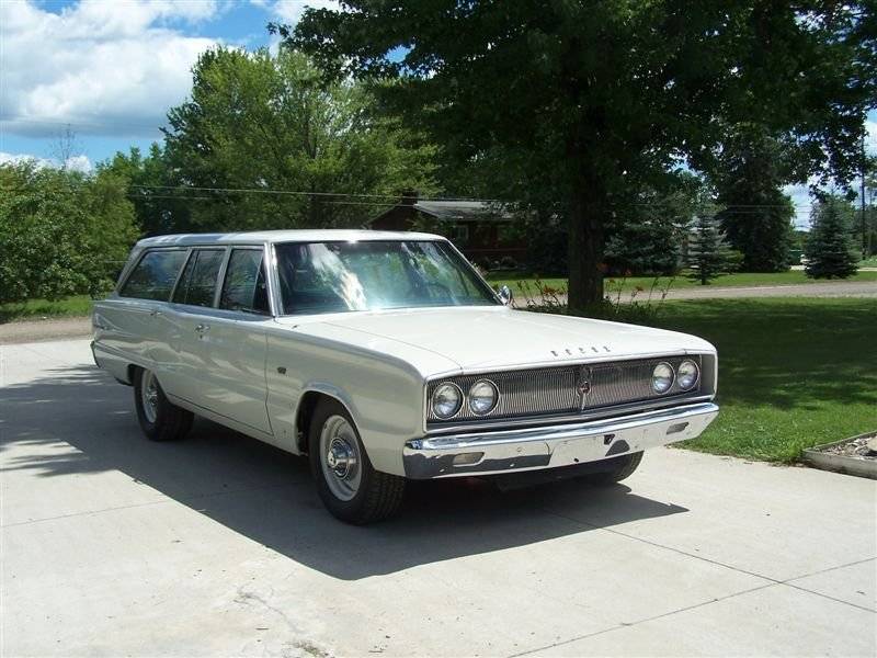

What could you possibly need more than 100 amps for ? Stock was like 40 !!
This car needed the most alternator of any car I've ever built.........
