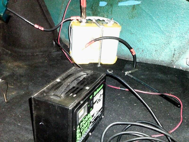

Charging a deep cycle battery on 2amps auto but the gauge on the charger says it's charging 14 amps. Voltmeter says the battery is at 12.8

does it drop down after a few min.s ?
that doesn't sound right for a 2 amp charge setting
check it with a different volt/amp meter
is it some auto charge setting or something else too ?
I went out & put my "old" 2/12/50 amp Schumacher smart charger
I checked dc voltage & amperage on each with a Fluke meter
voltage was 13+ when battery is fully charged, while the charger is connected
amperage setting was all within 2ish-5-ish amps,
sort of a spiked a couple amps at 1st off of each setting,
then went down to what it was supposed to be, give or take 1-2 amps
except the 50 amp setting it only works when cranking 'it boosts' up to 50 amps
when the battery is really drained (it's new battery) otherwise, it's like 12-15 amps charge too...
gauge on the charger is all over the map, I trust my Fluke Meter way more...

Sounds like it's fubar to me. Probably some diodes or a rectumfier or the like.
Yeah, thinking the charger is hosed......turned it off and a minute later it showed the battery is charged but the volt meter I have on the bettery shows 12v even.
