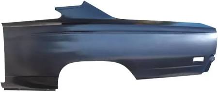

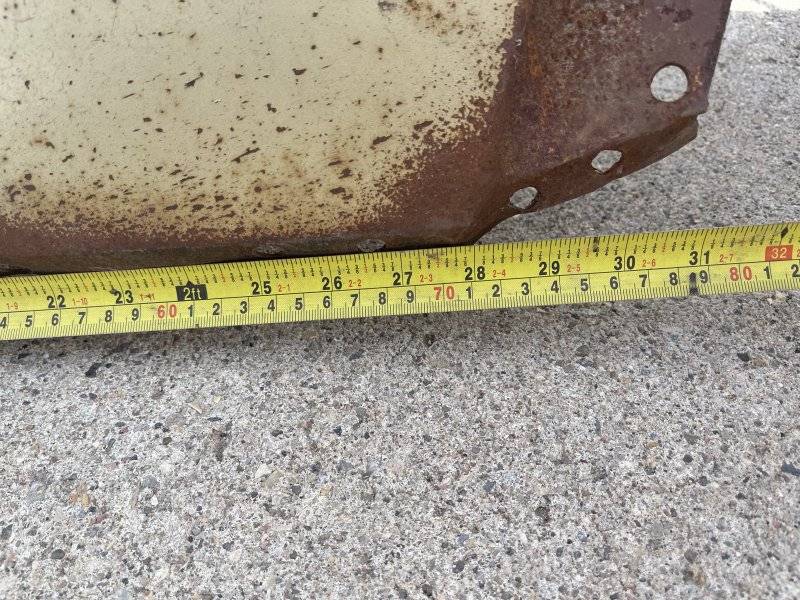

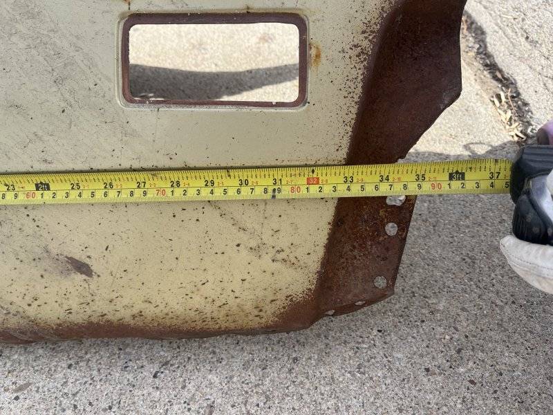

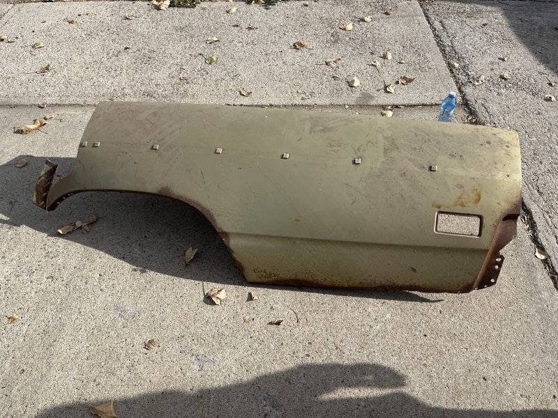

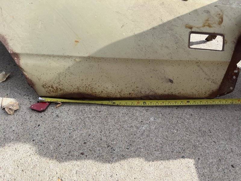

I know they are different, but I’m wondering if they may actually be the same below the lowest body line behind the rear wheel (and the wheel well opening). I just need the lower portion behind the rear wheel and have access to a salvaged 70 quarters off a 4 door and am thinking they’d work on the 69..
They sure look similar. Attached green 1/4 is from the 70 4 door. And of course the black in is a full quarter for a 69.

No.
...and additionally, the 4 door 1970 quarter panel is different at the wheel house from the 2 door.
4 door is not as high of an arch.
The outer wheel houses are different, too.
There was a big stink about this, as whoever supplied AMD with OEM outer wheel houses as a pattern for their repros, supplied 4 door parts
They 68-70 take the same wheelwell trim.
Could be dofferent where the bumper notch is.
