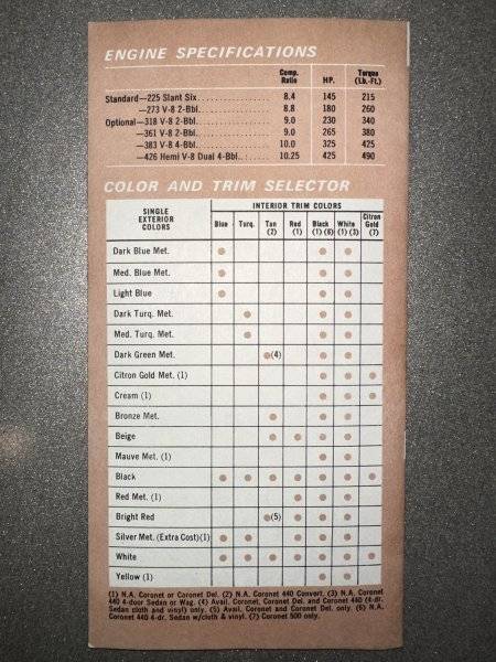

I figured out where I read “Citron”, it’s on a sales brochure.
What’s odd is that this thing doesn’t show any green colors (like mine) available for the interior. The options supposedly were Black, White, or Citron Gold. If true then this could mean that the green interior I have in mine is maybe for 67s?

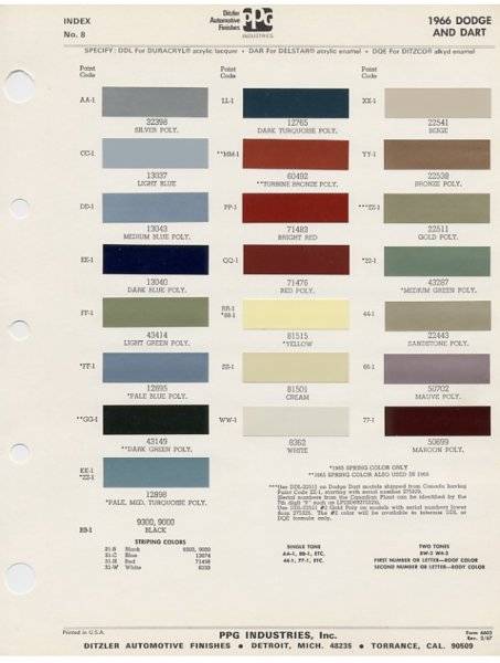

Also, Citron Gold Metallic isn’t a paint chip listed on the 1966 Dodge Paint Chip sheet. ZZ1 is listed simply as Gold Poly. Just a difference in semantics?

I’m really trying to solve for the green interior. I know what you mean about ZZ1. I’m okay with it just being semantics between the sales brochure and the paint chip sheet. But green interior parts for a ZZ1 paint might be the wrong answer for my car. Trying to learn what it rolled off the line with.

According to the pocket sales brochure it can come trimmed inside in white or citron gold.
