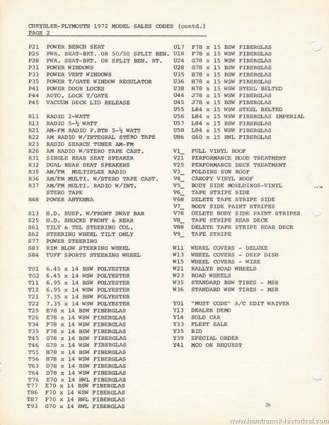

Is there a good broadcast sheet decoder for 1972 Plymouth?
72RoadrunnerGTX
8:36 AM
Jan 14, 2009
1,653
1,164
Shoreline, Washington
Short of a full '72 decode, here are the ’72 Plymouth specific order codes, broadcast sheet should be similar to the ’71 Dodge code layout. Should be able to decipher most of it.
Larger copies here
