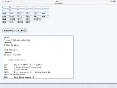

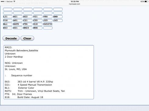

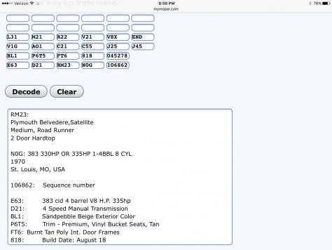

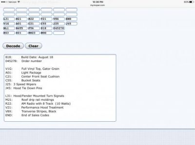

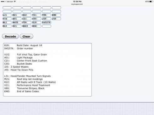

Is this a normal fender tag for a roadrunner? I thought these were stripped down cars.

The basic package was stripped down, but buyers still had a fairly good selection of options that could be added if they wanted.
By the way, the colour combo on that car seems pretty classy!
Agree with Photon. Most were stripped off the line. This one has some nice options.
