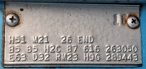

That doesn't look anything like my 68 roadrunner. Hold down screws should be centered along the side. The A/C tag is a separate tag.. about a quarter inch wide strip of metal 3 inches long that is simply punched completely through the metal showing AC.1969 Roadrunner with factory A/C. Shouldn't that be on the fender tag??I decoded and the A/C or P/S aren't listed. The tag is obviously not blue either.....repop?? fake?? How can I tell??
68's are a whole different animal than OP's.That doesn't look anything like my 68 roadrunner. Hold down screws should be centered along the side. The A/C tag is a separate tag.. about a quarter inch wide strip of metal 3 inches long that is simply punched completely through the metal showing AC.
H51 is Air Conditioning.1969 Roadrunner with factory A/C. Shouldn't that be on the fender tag??I decoded and the A/C or P/S aren't listed. The tag is obviously not blue either.....repop?? fake?? How can I tell??
The car is/was advertised as having the Broadcast Sheet.

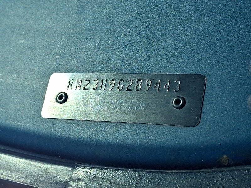

The seller doesn't have the best pictures on his website (using my cellphone). That being said, I don't like the looks of the dash VIN plate and attaching rivets.
