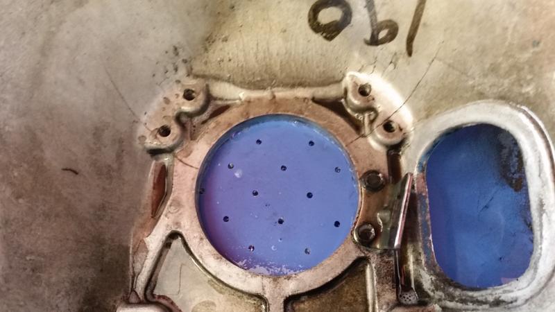

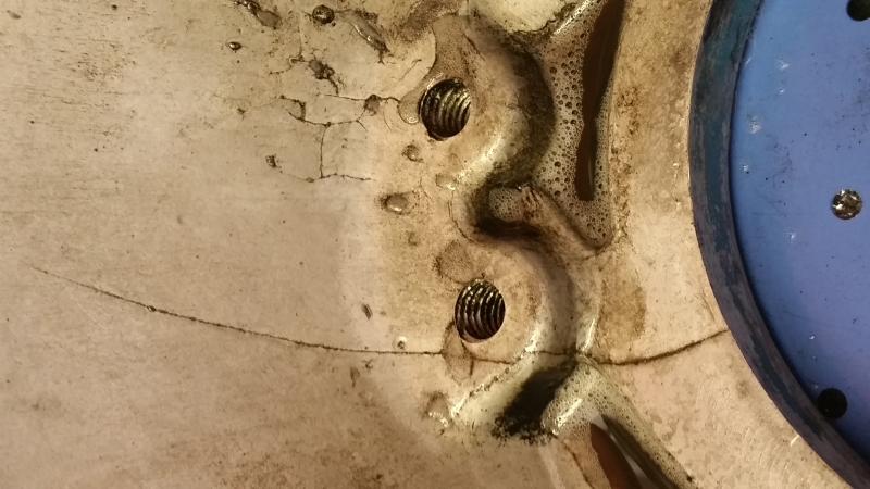

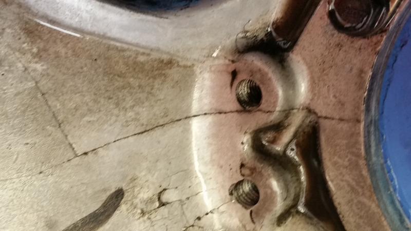

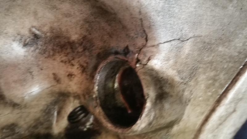

Cleaning up the bellhousing revealed this mess. Cracks do not appear to go all the way through. I'm sure that doesn't necessarily mean anything. Time for a new bellhousing? Thanks!

Somebody else on here just showed an aluminum bell with a crack that was welded up, just a couple of days ago. Anything can be fixed, it depends on whether the cost of the repair is worth it.
I'd be chucking that one in the scrap pile. I'd be to worried about it shattering whenever I dumped the clutch.
