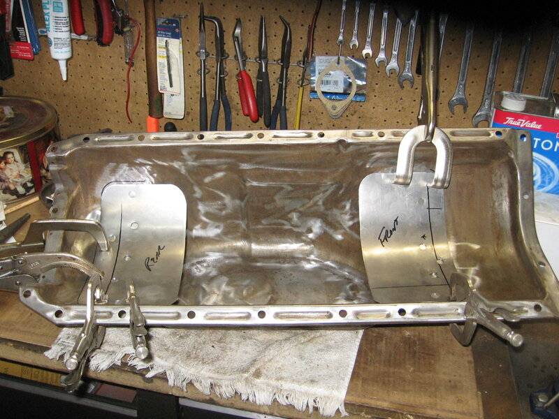

Home made oil pan baffles. Or called slosh baffles during acceleration/deceleration.
Photo is for reference.
Photo is for reference.View attachment 1119806
A big block Mopar, the pan is more squared so to speak and the baffles are pretty much flat so you can add some downward 90* breaks pretty easlily to control the oil more. A stock pan has breaks in the front and rear baffles that are about 1/4" long but I like them to be closer to 1/2" and maybe not quite 90*.....

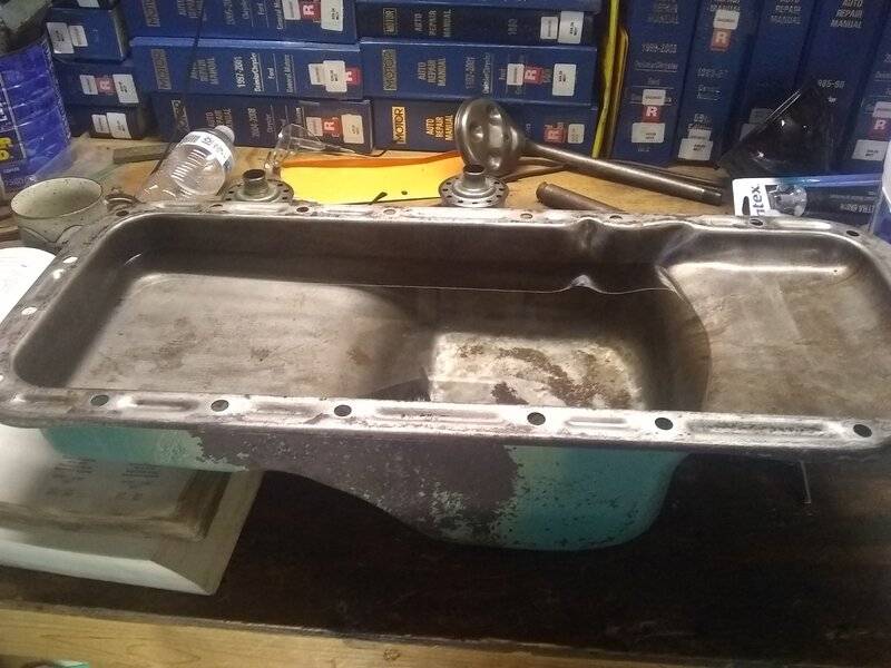

Guys, I am just breaking in my rebuilt 413.
This is a pic of the oil pan with 6 quarts of water in it. The water is just below the front ledge.

In my humble opinion you are overfull already in post #1. I think that is a five quart pan, meaning four in the pan, one in the filter. The water level you show is about were the factory baffles would be, if you had any.
I heartily agree with a larger capacity (hemi pan or better) with baffles, for your use.
