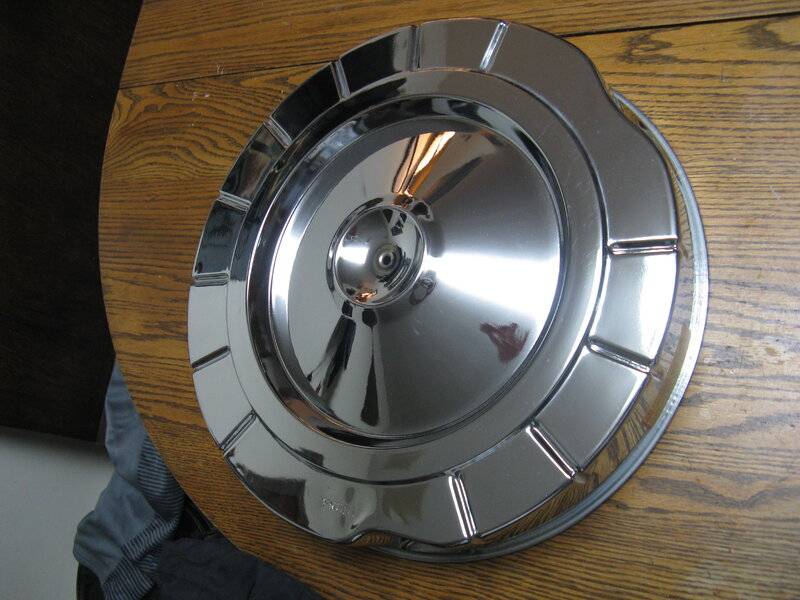

Is this the correct air cleaner for '68?
The photo in post #1 is the exact same as our 68 Coronet R/T that was bought new.

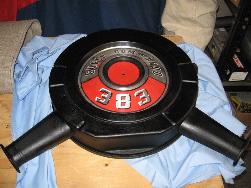

Back to Air Cleaners I think this is a C body from 1968 as it has oval snorkels and is for the AVS 5 1/8'' air horn.
Photo just for reference .
Yes worked at local dealership in late 67 to late 69 , saw many strange things from factory , I noted and thing to rattle in places , gotta love them though!

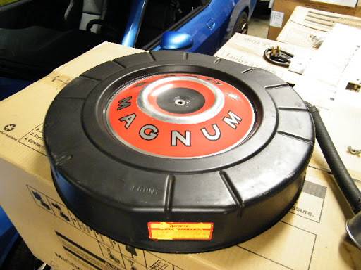

View attachment 1112591 while i agree that air cleaner is correct for 68’ i thought the early built 68’ air cleaner was the bigger one.also used if it had A/C or was a California car.

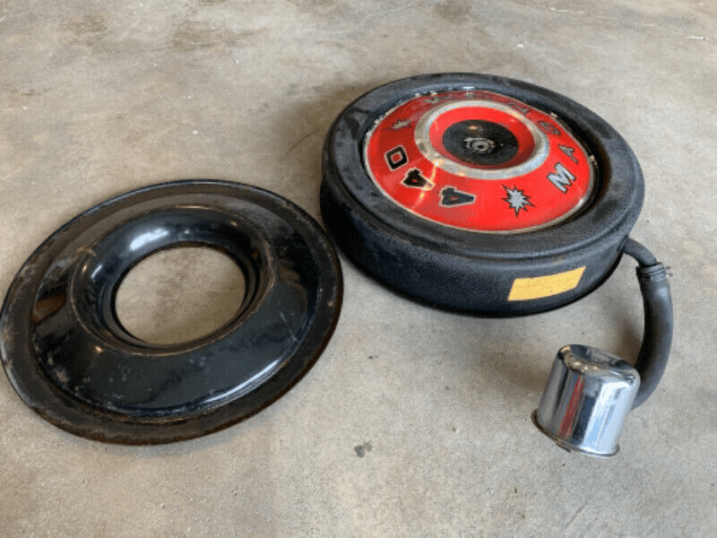

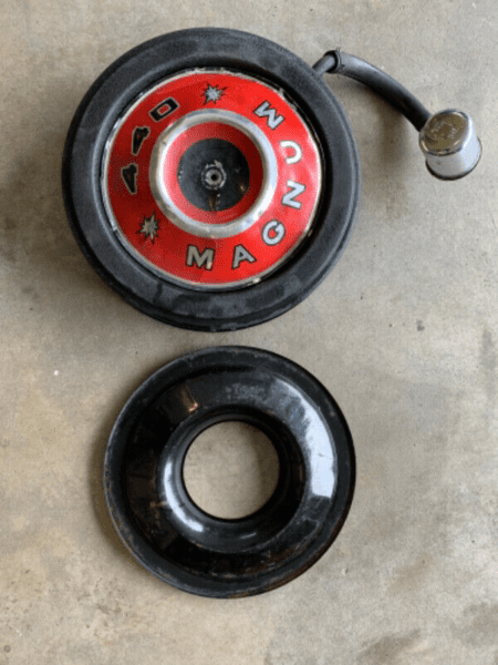

This was the air cleaner on my November '67 built Charger with a/c....
This is the more common 440-383 1968 & 1969 air cleaner....
Yes , first pic as one on the 67 440 Gtx I bought in June 67 unsilienced no snorkels
Got one of those early 68 Unsilenced air cleaners which are not as cool looking as the '64 426 wedge air cleaner..
