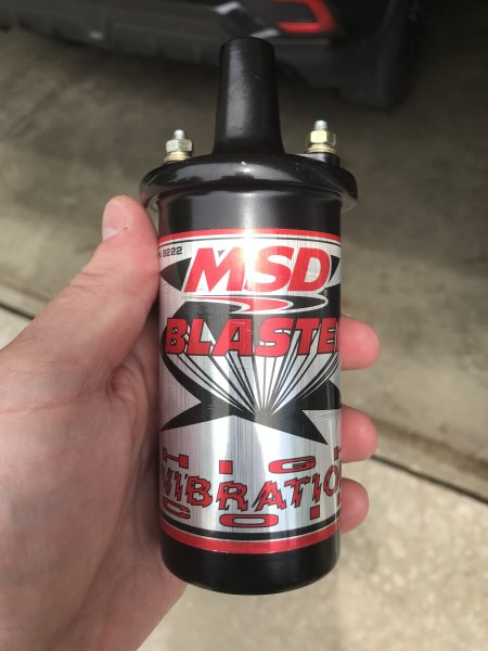

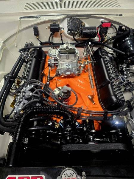

Hey everyone. I'm having major issues with coils. I'm running/was running the MSD Blaster High Vibration 8222 coil. I did about 600 miles on one coil and it bit the dust so I replaced it with another the very same and it only lasted 200 miles before it started to cause running issues and finally die. I'm using an MSD 6AL along with the pro billet blackout edition and no blast resistor. I don't have faith in the 8222 anymore so I'm looking for recommendations for an upgrade/replacement. I'm a bit particular about how it looks on my engine as you can see from the photo I've spent a lot of time to make sure things are as clean as possible and match nicely together

I checked out the MSD compatible coil list. I also contacted summit as I only purchased the coil last April. Yet again another happy summit customer. They have already dispatched a replacement for me. I'm actually shocked at how quick and easy that was. I'll be using that as a backup coil as I'm not happy about going through 2 coils in not even 1000 miles.

@nigel that engine bay looks CLEAN! Very impressive. The white engine bay really makes the black and orange pop.
