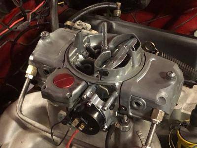

This is the carburetor.....

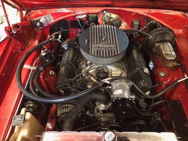

I've used this air cleaner since 2002.

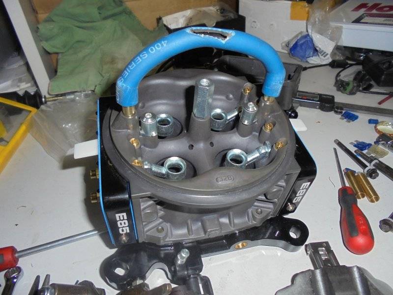

I like the idea of the hose connecting the two bowl vents. I could test it and report back once I'm up and running.
The other thing you can fit are float bowl vent baffles. The Holley ones are the best. I do a dirt car engine and we use the old hose trick as well as internal vent baffles and it works pretty well for no money. You do need around 1/2 and inch between the hole in the tube and the air cleaner lid. If you do not "vent" the float bowls the carb cannot work correctly. The hole cut in the rubber tube only needs to be about 6 mm. If pushed for height I will do several small nicks on the top side.
You can make little tube "stumps" out of 5/16 copper tube and epoxy them in to the carb body.
If you want PM me and I can email some pics of what I do.
