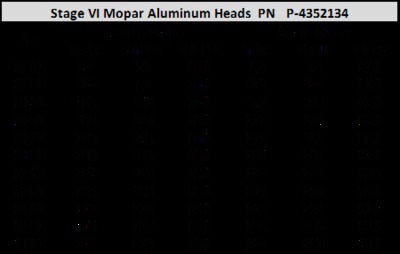

The heads are ported....I bought them that way and then the machine shop's head guy massaged a little more out of them. Here's the before and after numbers:

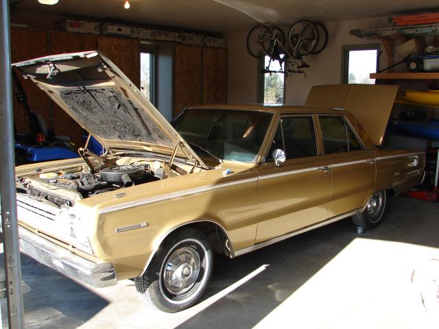

I'm pretty pumped about the motor....now I have to get the rest of the car finished to put it in, but I'm getting slowed down with helping my son rebuild a house. Here's what it's going into.

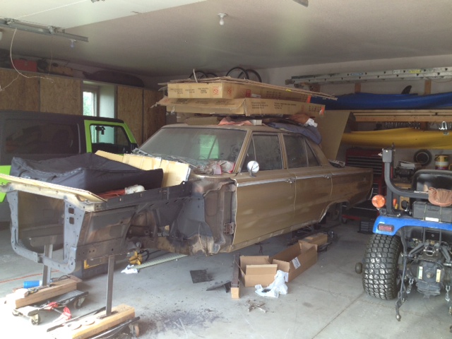

I know it's a 4 door....but it's rust free and the paint is good to go. I'm tying the frames, mini tubbing it, and adding a lot of stiffening parts from US car tool up front. It will be a 4 speed with a Dana 60 3:54 and Caltrack rear supension. Here's where it is right now
I have all the up front work done, and now need to concentrate on tying the frames and mini tubbing it. I'm shooting for next summer.
