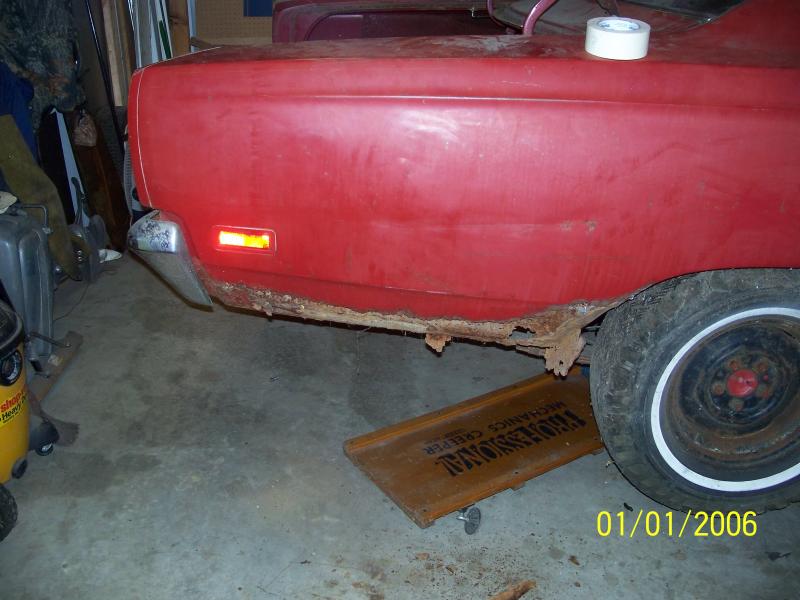

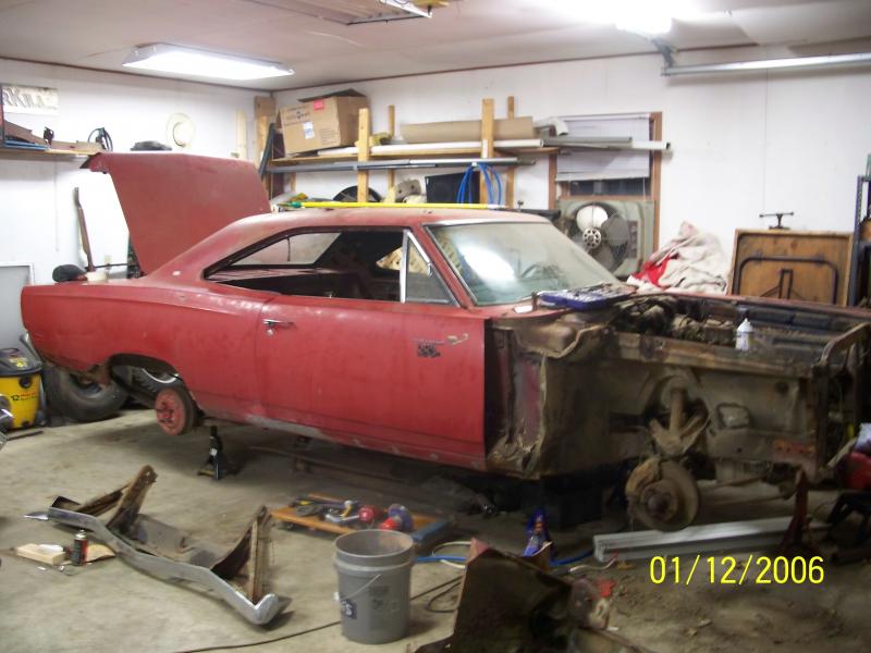

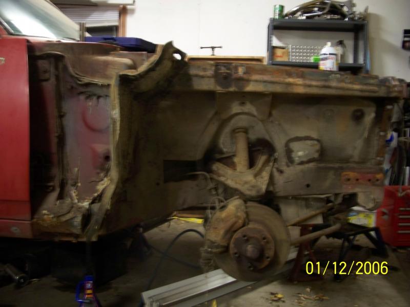

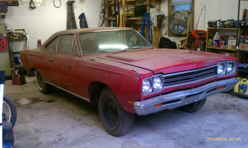

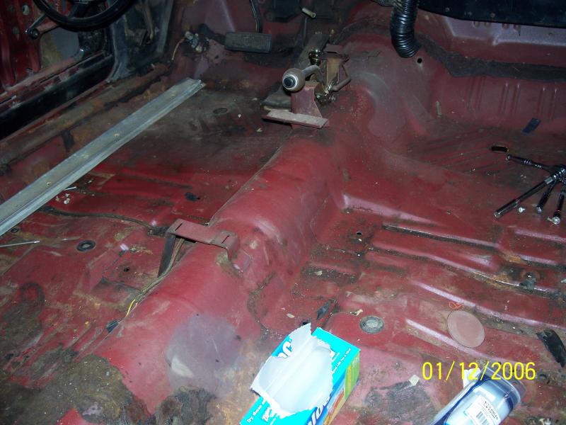

Well I have been reading every build on this forum over and over again for some time now while I have been working on mine (gaining knowledge) and figured I should share my adventure just as many of you have shared yours with me.
History: My ol man bought this 69 RR when he was 16 drove it like he stole until of a friend of his blew the original 383 about 35 years ago. It sat next to the house for about 10 years until he build a garage around it and sat there until June of this year when it was finally mine.
Plan: Build it as a driver just like she always was and see the ol man re-live some of the story’s he has told over the years about the hell he raised in it.
Pics show the progress I have made thus far (date stamp on the camera is off) but this is how far I have gotten in the past few months. It will be a build as money allows and planning to do everything I can in my own shop to save costs and keep progress going.

Great looking start, especially after sitting for so long. I'm really jealous of those floors! good luck and try to keep us posted. '68-'69 cars have always been my favorite. '68 RR was what got me into Mopars!

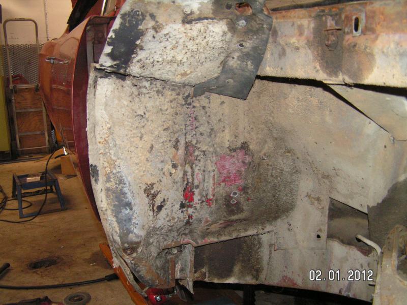

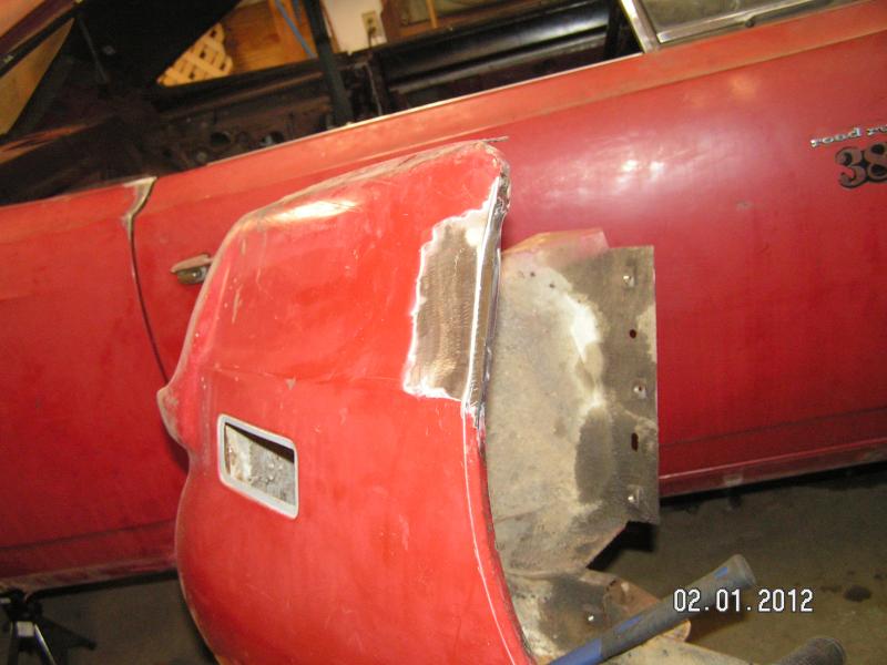

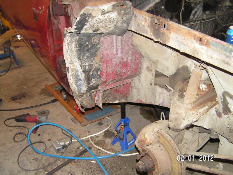

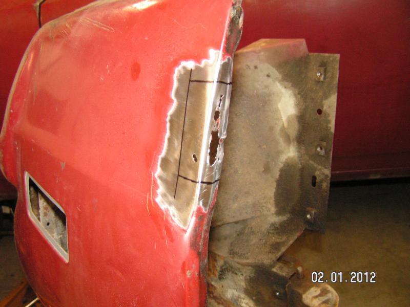

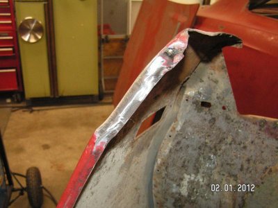

Well got my new IR125 scalier today and prop was exactly right when he said this is the only way to remove undercoating. Hand to try it out and scaled a small part in about 10 minutes......this thing rocks!!
Also snuck in a little surgery on the front fender as well. Things have been moving slow but at least were moving still.
Still need to pull the front and rear glass, got all the trim removed, just gonna kick out the front since its broke already. What’s the best way to cut the rear? Using piano wire or are those kits with the wire and two handles worth the money?

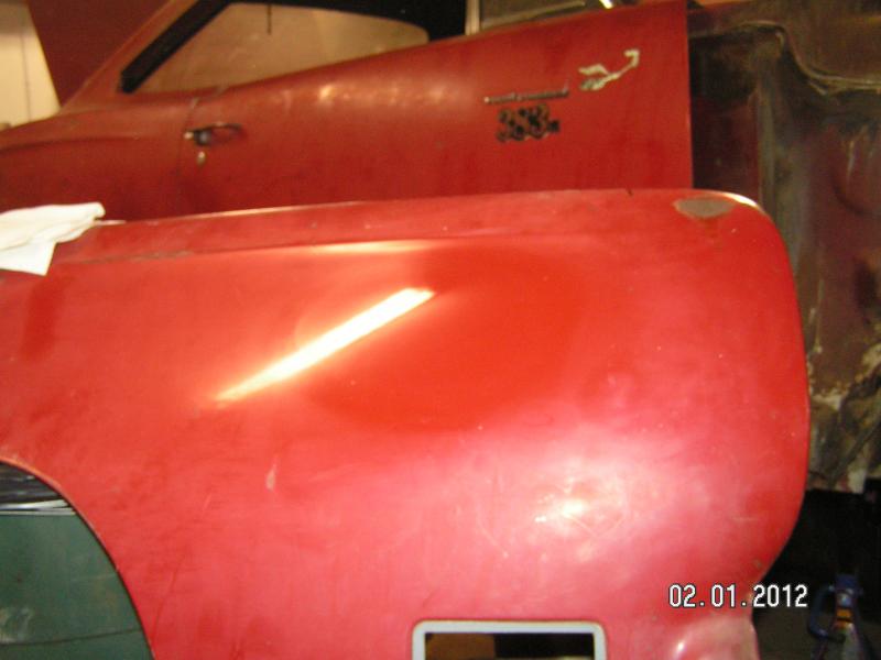

Oh yeah I couldn't help myself and see if that old factory paint would shine. Little wet sanding and wax and she shined right up.

Great patch work es1758! That's amazing that paint comes back so nicely. Glad to hear the Ingersoll needle scaler is working out good for you. They're dirty, noisy and require a bit of labor, but hey...at least they actually work.

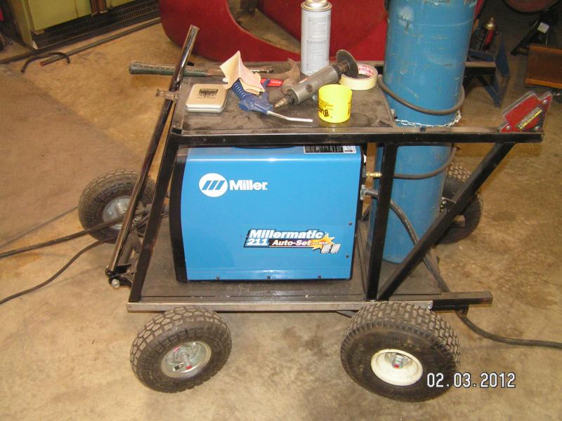

Looking good...Keep up the good work! Is that a Millermatic welder you're using there?
Yeah its workin great.
Yeah its a miller 211. It works great has the multiple voltage option so I can run it 120 or 220. Heres a pic of it sittin on my welder cart with four wheel steer that I built.
Not much progress got the trsion bars out and getting ready to drop the K member.

Nice set up with the cart. Has to make it a breeze to roll around.
