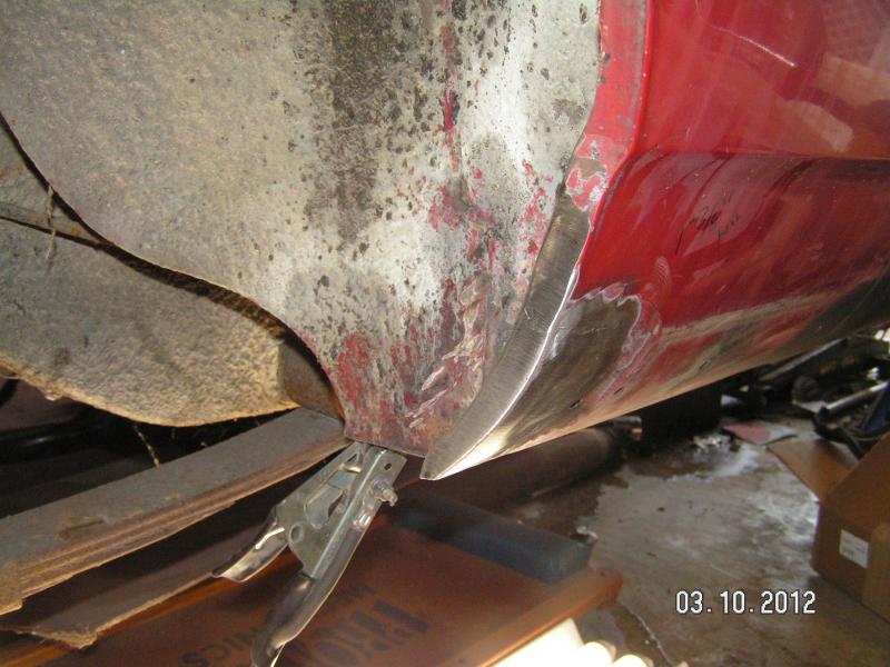

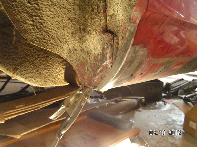

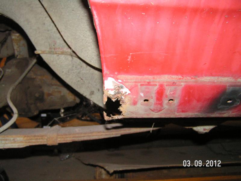

Well got a little time to work on the Bird this weekend got the cancer removed from the front of the rear wheel opening and started cuttin away at the rear lower quarter to do repairs on outer wheelhouse. Any one used the lower rear patch panels from AMD, im curious at to how good they fit? Also got the front and rear glass out to show more cancer on the lower rear window frame which was expected. Next thing is to pull the dash now that the windshield is out. Anyway not much progress but shes coming along.

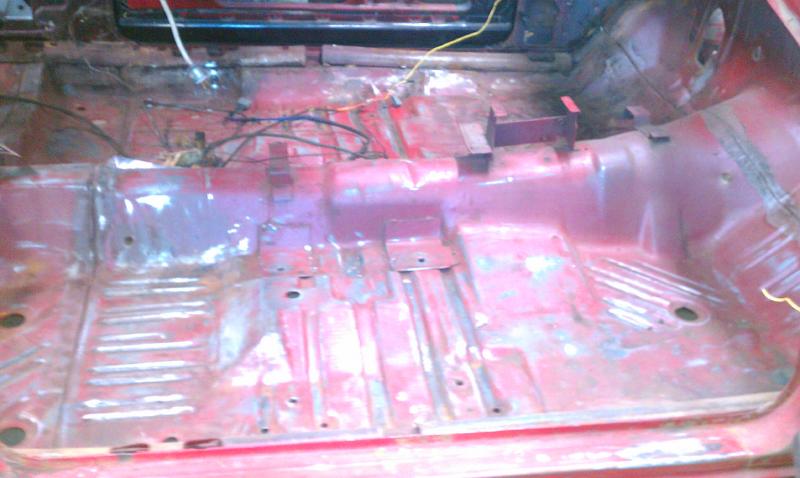

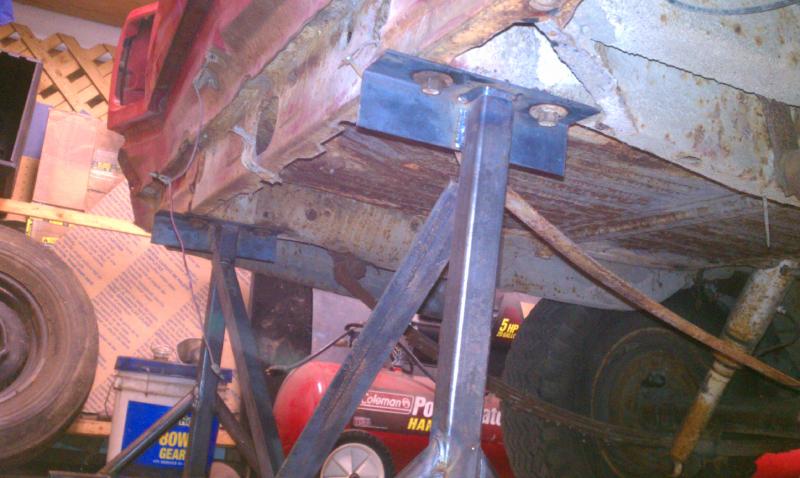

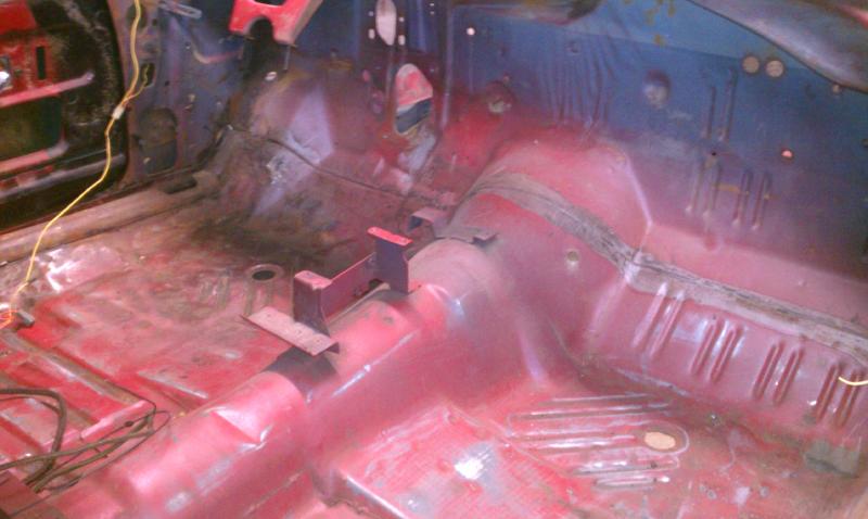

Wow 11 pages deep to find it but that’s what I get for not posting in almost a year. Well it was slow going for quite some time with months going by with no time to work on her but we are back on course and plugging away. Well since the last post I have stripped it down to only a shell and started stripping paint and prepping for primer. The wife was gracious enough to buy all my sheet metal for x-mas so I have started prepping to repair the rear quarter sections, rear window corners, and install the 4 speed hump. Had a nasty crease in the quarter so I have started to beat it out, slowly but surely it’s coming out. Well not much of an update but will have more to follow. Im still kinda trying to find a process to all the madness, so much to do and and trying to figure out where to start. Also built some rolling stands to move it around the shop, is it ok to attach to the rear section as I have it in the picture.

only thing to watch for on the stands is hitting something while you are rolling it.if the stands are not attached to each other(cant see the bottoms)they can fold under fairly easy and cause monster damage.project is looking great so far.keep it up!
Yeah I got a cross brace across the bottom and some x bracing, just didn't know if it would sag over time

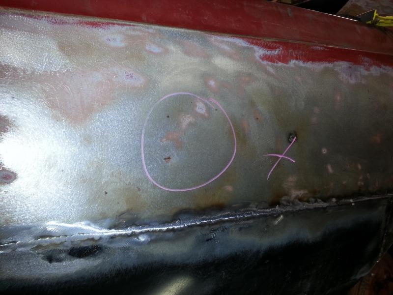

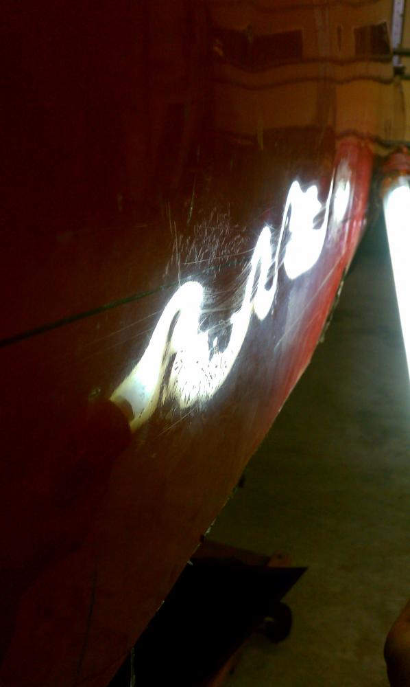

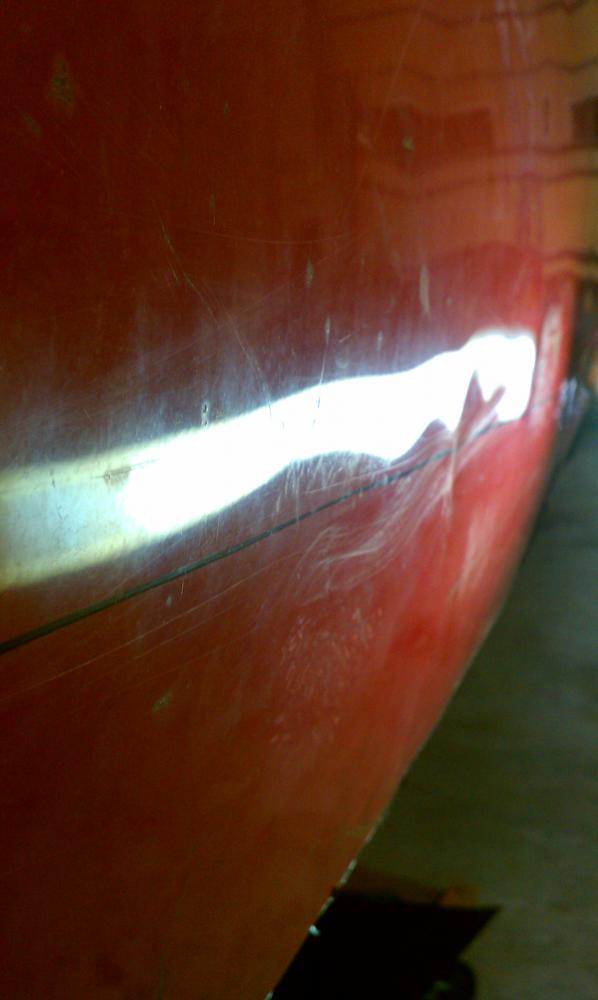

Well still been plugging away on the bird. I got the patch panel in on the rear quarter and even though I went extremely slow to avoid warping I warped the top side of the quarter. It is oil-canning and im not sure if I need to shrink or stretch any help would be great. When I push in on the pink circle the pink "X" pops out and suggestions as how to approach fixing this. Sorry for the crappy picture
Heat up the circle with a torch and then hit it with a cold wet rag to shrink it. Youtube it to see exactly how. Nice project by the way. glad you were able to keep that runner in the family.
