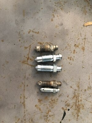

Ive ordered 3 different bleeding screws and none match

I have a 71 satellite and am trying to replace the bleeding screws. The front screws are thicker and fatter compared to the back brakes have more of a skinny long screw. Where can I find these screws? I've ordered from Advanced and Summit. None of them match.

Im having a real tough time finding ones that match mine. Will do some more digging.
Save yourself the headache and order a set of speedbleeders, http://www.showmetheparts.com/Speedbleeder/. Pretty simple, just go to their website and type in your car, it will then give you part numbers of various brakes available, select what you need and it will spit out the speedbleeder part number. I have them on my 73, saves time when bleeding the brakes!

One reason why you buy a different caliper/wheel cylinder: the bleeder is seized or it twisted off. The re-builders just drill them out and tap them to the next size (usually metric) and install a bleeder screw from another application. Your bleeder may be anyone of a hand full of different sizes.
