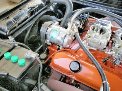

Buy a group 27 from NAPA,right size,same as group 27 reproduction,810 c amp and you can remove the caps and get a set of correct Mopar reproduction red caps from http://www.turbostart.com/ and it will look correct,will cost you around $90..
Buy a group 27 from NAPA,..
