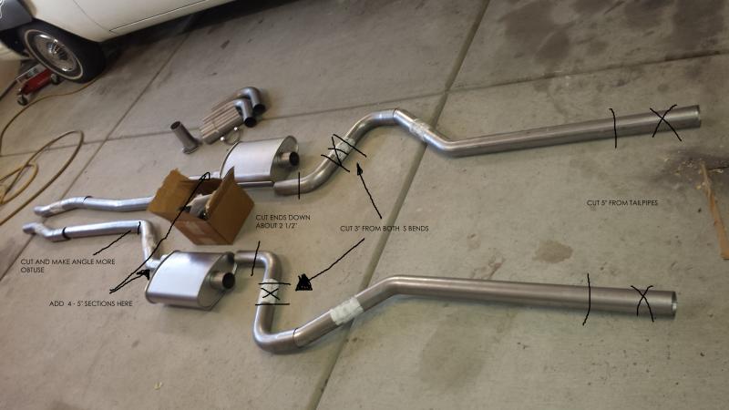

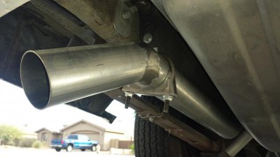

Update: I got the kit in and it looks good. Thick wall 2 1/2" and includes all fittings. I also picked up a TTI header adaptor off of eBay for a good price even though the Jegs kit includes a generic adaptor. The TTI adaptor uses a thick flange.

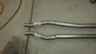

This kit needs plenty of modifications. The tailpipe is about 10" too long. The S pipe needs 3" removed from it to fit as well as cutting down the piece that fits in the muffler.
The straight section ahead of the muffler needs about 5" added to it. The driver side tube needed the bend straightened a bit to allow room for the pass side tube to t7ck up by the driveshaft. The header tube were pretty good although they don't quite center on the trans crossmember exhaust cutouts. I did have to tweak the pass header tube angle to get the straight pipe down and under the ebrake cable.
I am adding in an H pipe by the trans mount and I still have to put rear mounts for the muffler tailpipe.
Pics to follow when I get home.
I think the Summit kit is the same as the Jegs. Mine was made by Maremont. I had to do the same modifications that your doing to make it fit on my 65 Coronet. All I had to do to the tailpipes was shorten them, otherwise they fit perfect. It sounds awesome and am very happy with mine! It was worth the extra work!

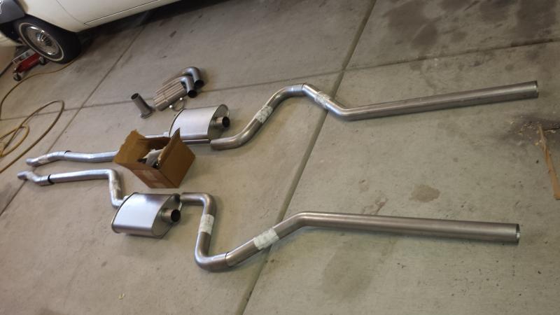

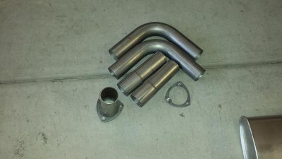

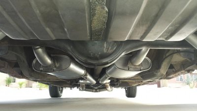

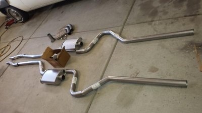

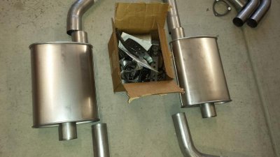

Here are the pics as promised. The kit includes everything. As stated earlier, tail pipes need cut, s bend needs trimmed, long section needs 5" added on and a few of the angles needed tweeked.
As shipped

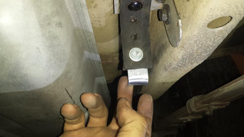

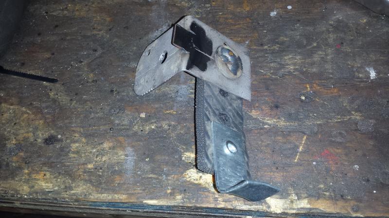

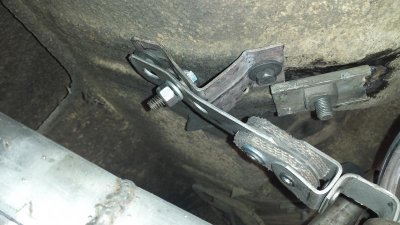

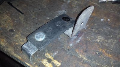

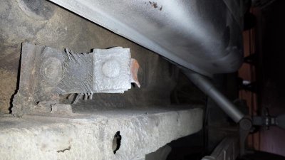

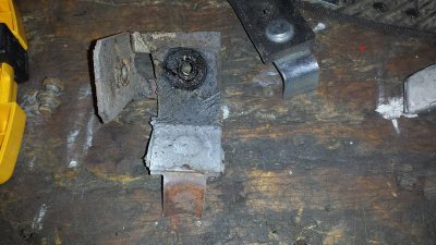

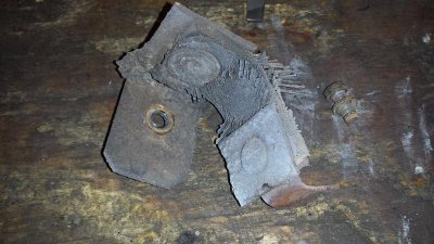

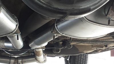

Going from single exhaust to dual exhaust required 2 brackets on the pass side, tailpipe and muffler. The tailpipe bracket cutout was present on the pass side, just need a U nut, bolt and bracket. My fabricated bracket is a mirror image of the driver side bracket (which also needed repaired).
Muffler bracket

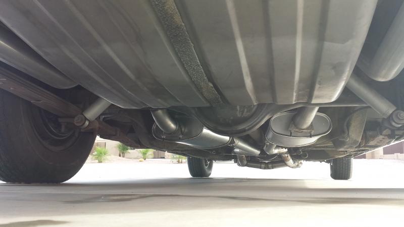

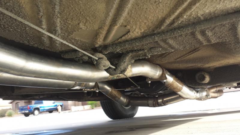

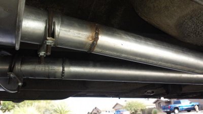

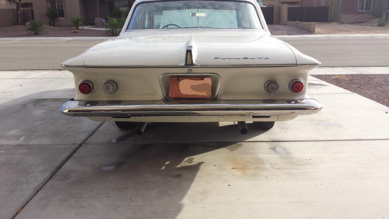

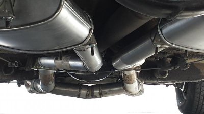

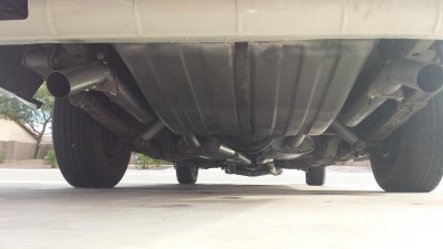

Final product. The H pipe sticks down a little lower than I would like but it is all welded solid and sounds nice. Hopefully some of the welded areas can be seen in the pics to give you an idea where they needed modifications. In total, it took me a day and a half to get welded up. Some of it was easy and some was frustrating (H pipe being frustrating). A few of the welds were done with an ill advised attempt with stainless wire when my regular wire was used up.
I would do it again as I like welding and fabrication. $254 vs. $700 is a no brainer to me. The exhaust sounds great, nice throaty rumble and I only noticed a little drone down low in the rpms, around 1500-1700. Cruising the highway was drone free. I'll try and get video or sound up in a day or two as I am working on fixing a coolant leak.

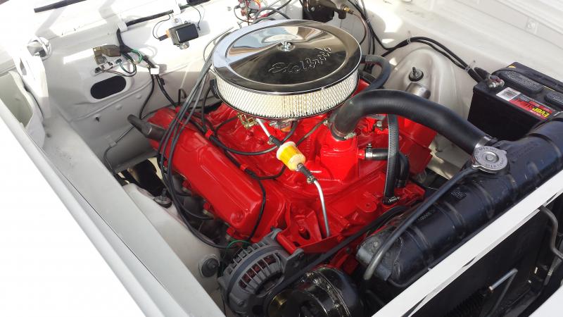

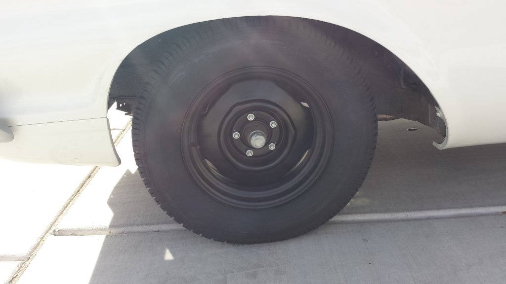

Here are a few more pics of the car.
