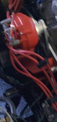

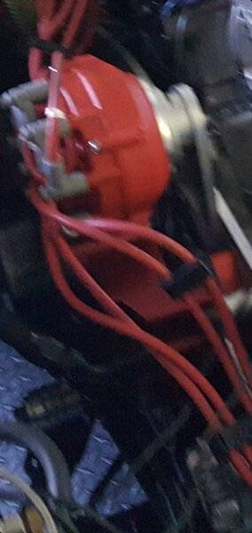

I'm using the AR motor plate and it fits fine.
Here's a picture of mine
