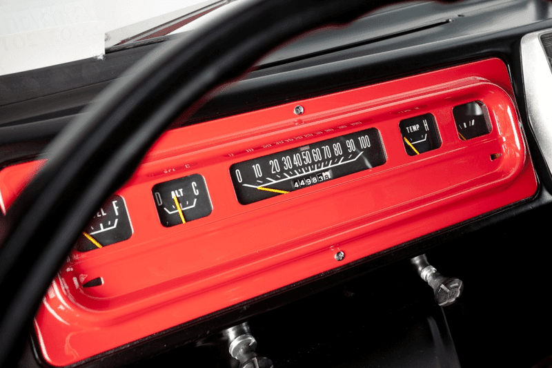

I made a discovery about 9 years ago....if you connect up a similar make temperature gauge to the oil pressure switch, you get a reasonably accurate reading. must try that the other way around.
It was found that the internals of my test OIL and TEMP gauges, that they have the same electrical properties....meaning a swap out is easy - except if you have any lettering on the gauge face.
I have successfully run a blanked out temp gauge for the oil pressure for the last 8 years - in my A100. Only thing missing is the numbers....BTW the truck only had an idiot light previously. Swapped out the sender unit also of course.
Note that the numbers are missing on the OIL gauge (right hand end)

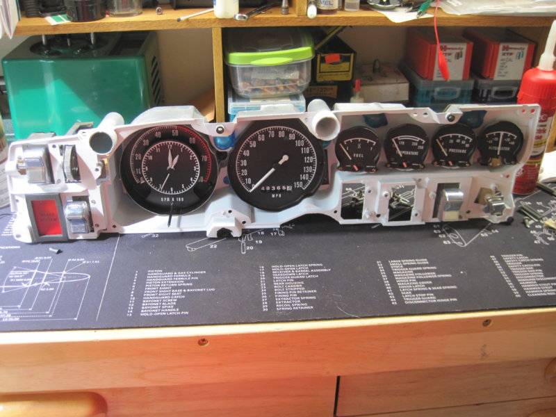

If you zoom in on the attached picture, you can see a small white circle on the Temperature and Oil Pressure Gauges. On the Temp gauge, it is on the left side, northeast of the left side brass rivet. On the Oil Pressure gauge, it is straight east of the left brass rivet. No extra hole on the Fuel gauge. There is a corresponding hole on the gauge faces that tells what the gauge face was originally.

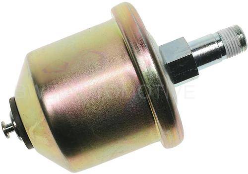

From what I've gleaned on another thread I shamelessly started, there is supposed to be a physical wire attached to the top part of the oil pressure sending unit (seems to be giving a very high oil pressure reading @ 3.1 ohms).
I found a disconnected, chopped off grey wire, which according to schematics should be the one that leads to the back of the oil gauge. Gonna run a continuity to make sure.
Gauge bad, wiring bad, sender bad!
If I get this sucker resolved I'm gonna have to buy the forum a round on me. :drinks:
Oil Gauge = Completely dead
Any chance you've pulled the oil gauge out of the cluster? Not always, but have looked at some, where it was something minor that kept it from working. Studs corroded, and the like.
the little bell shaped contraption
Is that one on the top of the oil pressure sending unit? Just in case you might not know, it takes one of the 'female' type spade connectors, that slip onto it. Normally would have one of the single plastic covers over it, that has a slot on the bottom, to slip past the pin connection. (Best way I can describe it.)
That helps a ton! A member showed me a photo of what it's supposed to look like but I couldn't get a good look at the connection type. Good to know it isn't some fancy boot and just one of those dime a dozen connectors that'll glide right on.
