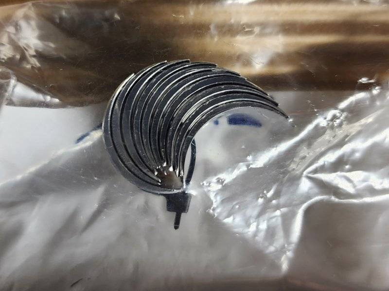

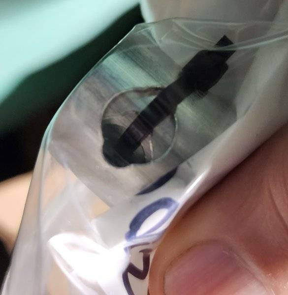

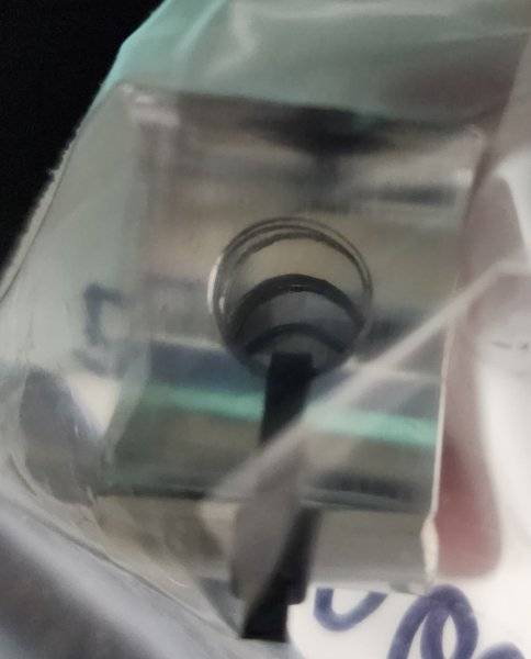

I see the holes in a couple of these valvetrain geometry correction spacers are different shapes. On one end of the zip tied stack the hole is basically round, but some have additional material removed at 12 and 6 o'clock.
Can anyone tell me about this please?

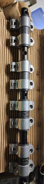

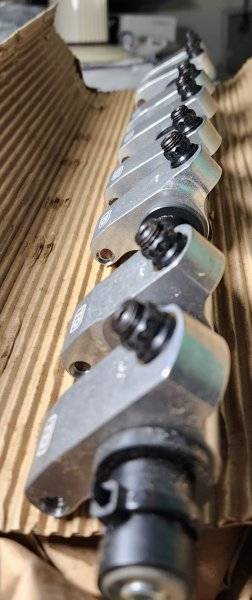

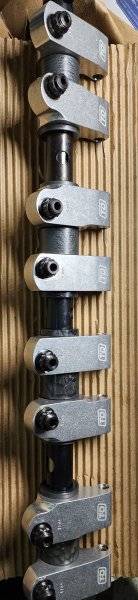

And I can't help but show off my rocker arms before I send them off to the builder:
Those go in the bolt holes that pass oil to the rocker shafts. 4th bolt from the front on each side.
So since I'm not cutting that zip tie that holds them together, there should be 2 "odd" ones w/the extra material removed, and the other 8 just a "circular" opening?
Thanks!
Thanks!
Yeah there should be an 'oiler' for each side. Lawd have mercy I can't wait for that engine to come to life....!
