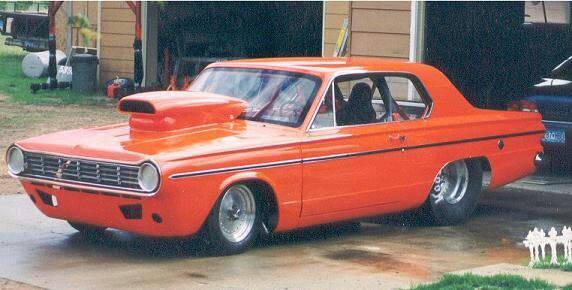

If you have the option, moving the rear axle forward is VERY helpful. Anything you can do is a help. For asthetics , i limited the move forward on my drag car to 6 inch. That and 17 inch engine setback equaled tail draging wheelstands at 700 hp. At 880 hp, uncontrolable.
I appreciate all replies, but that is WAY beyond anything I even thought about doing.
