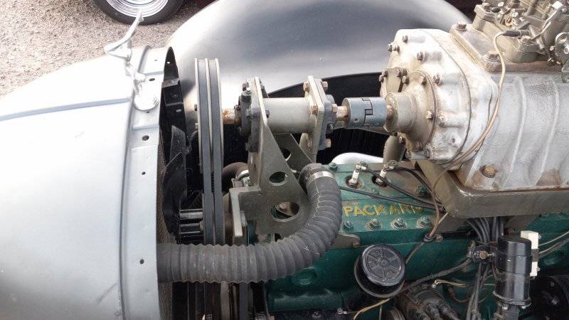

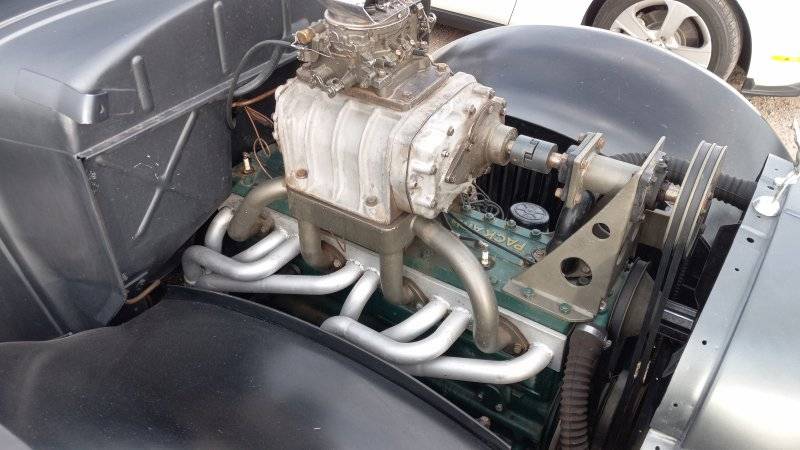

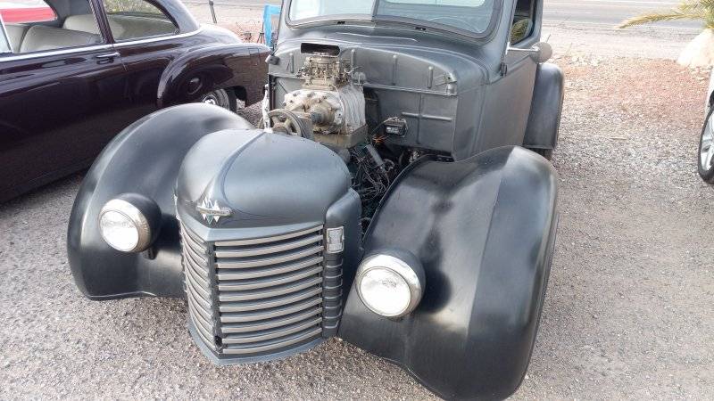

Saw this one at a local show in AZ. Homemade 8 into 2 header, homemade intake for the 4/71 blower, and homemade blower drive, on a Packard eight, in an International pickup.
