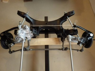

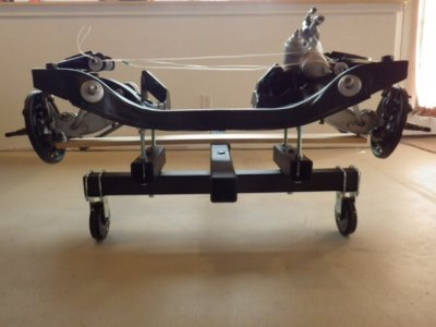

Yes mine was simple since this will be used once for my one and only project.....

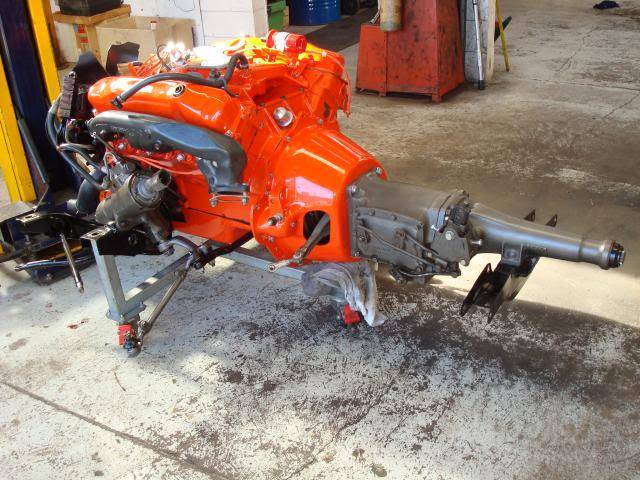

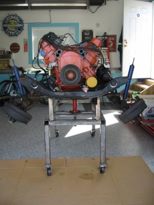

You mean like this....
to do this....
I'll get some dimensions for you shortly if that's what you are looking for :)

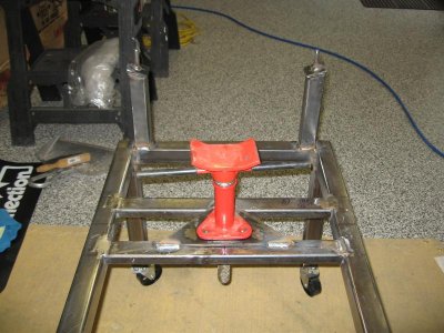

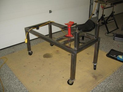

Here's what I fabbed up for mine...just getting around to posting a couple pics now.
This job started out as sending in my 727 for rebuild. After sending it out, I decided to drop the motor for some top end goodies and front suspension work. The screw jack relocates to the rear so you can pull the motor only, or drop the motor/trans together. In the pics, the rear brace and mount for the rear, aren't installed yet. It's the same as the one in the pic tho, that way you just un-bolt it and move it to the rear.
I'm always short of table or bench space, so I can throw down a piece of 3/4 plywood on it and use it as a rolling table/bench, when not in use as a cradle. Trying to make it useful as it's another chunk of steel I'm tripping over otherwise! Between engine stands, shop cranes, and now this, the floor space gets eaten up.
