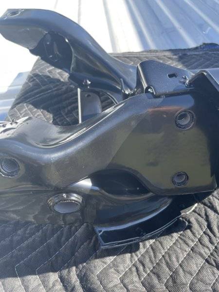

Clean, blast, epoxy primer, paint.

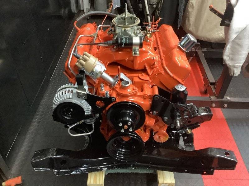

Kind of a different view.
Go through this thread , do all the extra welding and add the reinforcement plates. Or have it done for you. Then get the baking and powder coating done.
