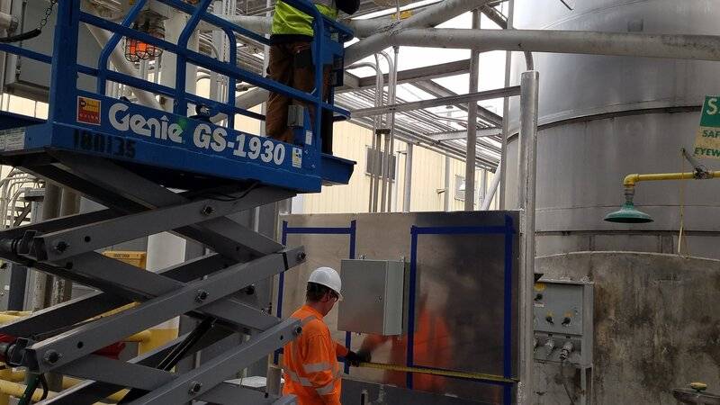

Welded some aluminum plate and supports up for my guys to mount some panels....I don't do it often, but I've done worse:rolleyes:

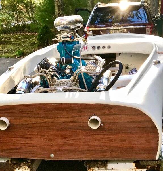

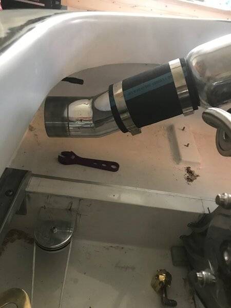

My homemade rotary weld positioner and the exhaust pieces for my boat (it's got a 431 stroked B block and a tunnel ram)
None of my friends will ride in the boat, what is wrong with people?

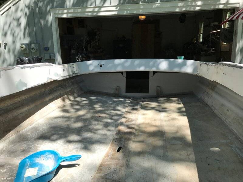

The boat is a 1968 17'6" Rayson-craft built by the late Rudy Ramos. I've stripped the hull down to nothing and built new stringers, spent a lot of time getting several old paint jobs off. The motor ran "ok". Basic 9:1 383 with 452 heads and a Comp Nostalgia cam. I used the block and the main caps...... Got a 440 source stroker kit and heads with an XE280S cam. Found the Wieand tunnel ram on EBay.With a 25% overdrive and a 12x11 2 blade wheel it turns 6800 which is 75mph. I know it will pull the same rpm with more overdrive, but this hull is not safe at those speeds. The hull is in body shop jail getting paint. The transom is an exotic wood veneer I vacuum bagged on. And then I liked the Mopar motor so much, I went and got my RR and I'm building a better motor hehehehe
