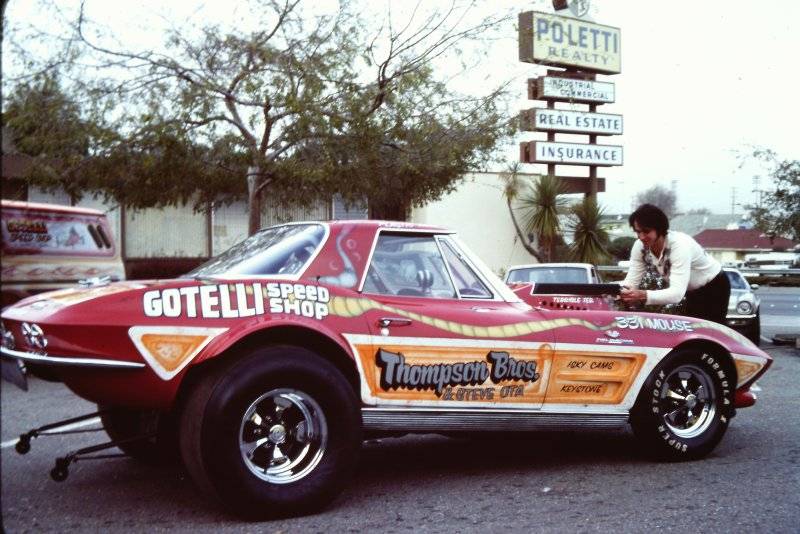

Cragars are made that way as well. Sox and Martin ran them for years.

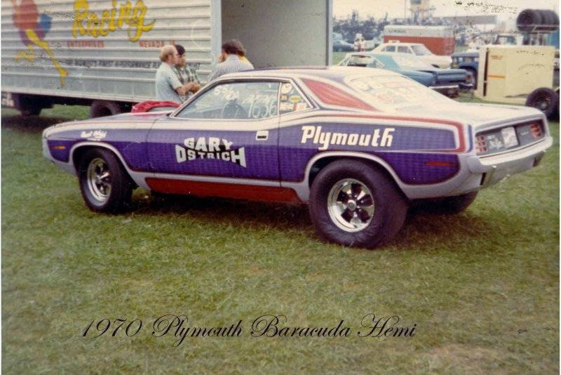

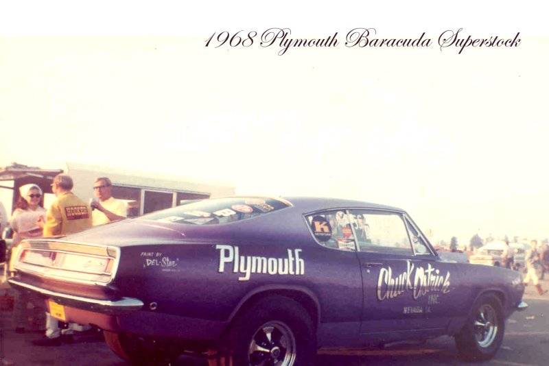

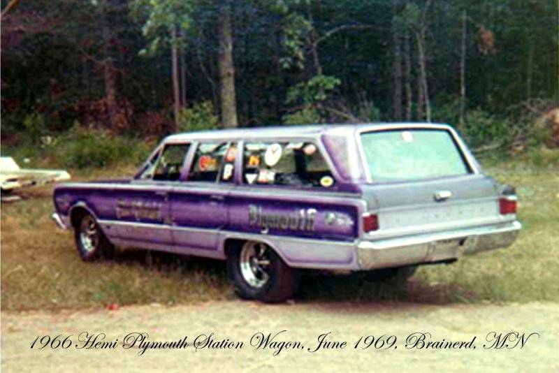

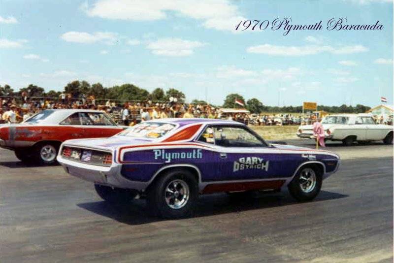

Chuck Ostrich ran them on his Hemi Super Stock cars.
