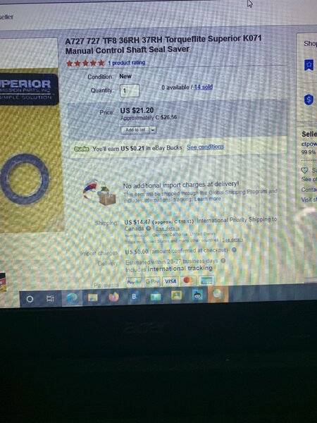

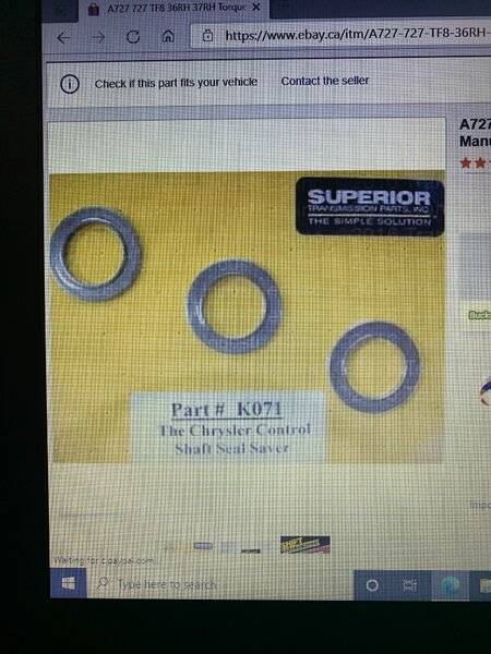

Could be the bypass is sticking. U could try cleaning it. Or put on a new pump. Also there is a washer type seal that goes under the manual shaft seal to take the slop out of the valve body shifter shaft. It’s like putting a washer on to a bolt. They come in a 3 pack from EBay. Kim
What is the name of the seal ?
Here it is. Kim
