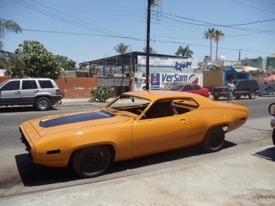

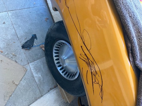

I thought my Axalta Prep Sol 3919SM would have wiped the marks away instantly, but it was basically ineffective. I resorted to an old bottle of Blue Magic Road Tar & Bug Gel. I applied it and rubbed it off maybe ten times (lost count) and finally got the marks almost faded away, but not quite. I began to see a little yellow paint show up on the towel, so I decided to quit for now. Two different Grand Kids, five and six years old. You can see they have different artistic styles.

My '71 Satellite was vandalized all over with some type of permanent marker back around 1976. I used a brand of bug and tar remover that was very high in petroleum distillates. It worked with a lot of elbow grease and I followed up with Johnson's paste floor wax which also contains petroleum distillates IIRC.
I can still smell that stuff. :p

I’ve never touched dry paint with acetone, it readily removes permanent marker, but I assume it is detrimental to paint.
You won't believe what I'm using to remove old, painted "custom" pinstripes from my 928.
Easy-off oven cleaner. I apply it with a Q-Tip and then rub with a white Mars eraser. Followup with soapy rag, wet rag, and then a dry rag.

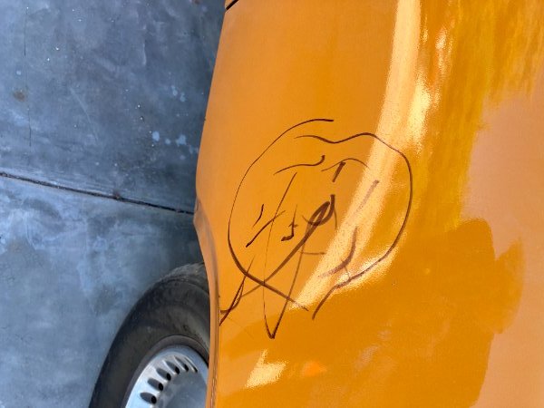

Different artistic styles but the same red stripes on their rear ends.

I use alcohol, if it's a sharpe marker. Watch using oven cleaner, if it gets next to a paint edge, it's coming up.
