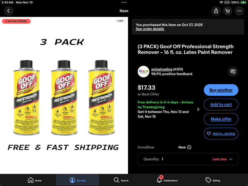

Goof off. Just did some rust repair on my Lincoln. I used it to get fresh overspray and primer off for spots I was working on. It took fresh paint and primer off but didn’t hurt the original factory paint. If the markers are fresh I’m sure it will work. It has to be Goof Off and not Goo Be Gone.
I have a Duster with a rattle can black underhood paint job, that I wiped off most of it using Goof-Off and Acetone. From the smell of them, they are basically the same thing.
