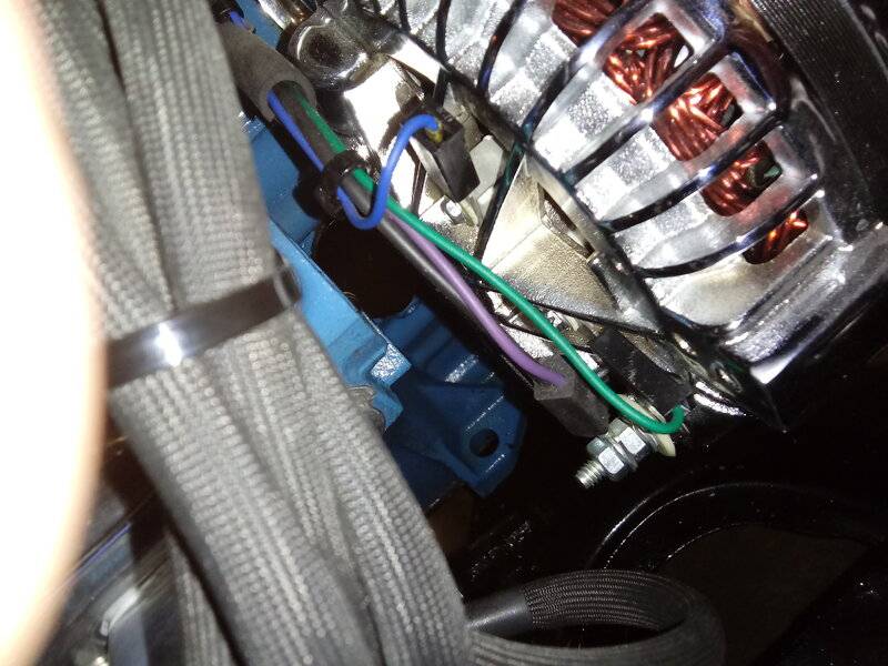

On my 440 street/strip charger I have a kill switch on my tail panel which kills the battery connection, but as I knew already the alternator keeps the motor running. I think I've heard if I disconnect the wires to the alternator the motor will then quit when the kill switch is turned off. My questions are-> #1 Will that work, and pass tech/safety inspect? #2 Will the motor still run ok for a few passes? #3 Will it hurt anything? #4 Which wires do I disconnect., Can I simply unplug the quick connect blue and green wires or do I have to "unbolt" the big black and purple wires also?.. I'm running a stock electronic ignition and a yellow optima batt. Also my kill switch is breaking the negative/ground side of the battery connection, which I don't think makes any big difference.. All and or any info appreciated..

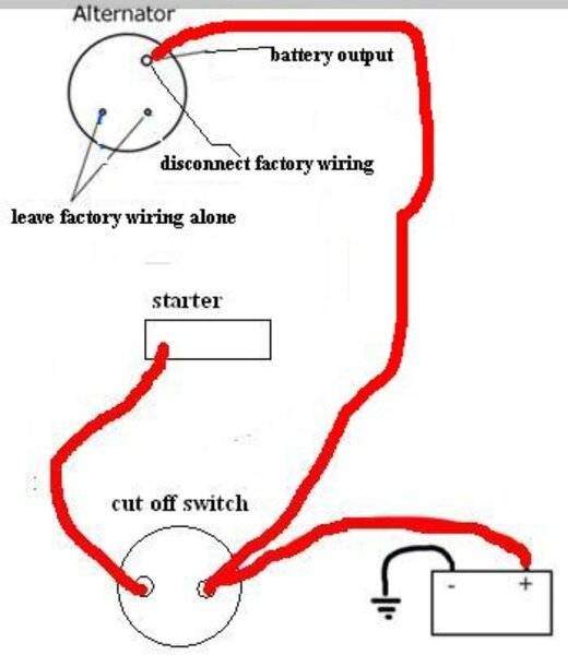

bobtile's diagram works for a normal wiring scheme. Mine is different because I have a second wire that is parallel to the wire to the starter , but feeds the panel feeding my ignition & fuel pump & spares for fan & water pump..

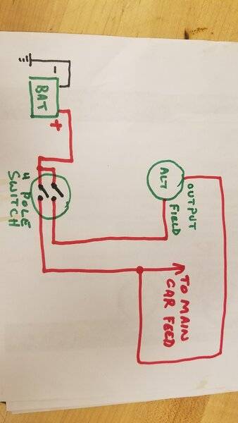

I use one of the 4 pole cut off switches. The two large studs were for the battery positive line. The two small studs were wired up to supply a ground for a relay. That relay would be on with the cut out switch on, and off with the switch off. This relay supplies power to the voltage regulator/alternator. I have been to tracks that have you start the car and test to verify that the engine dies when the switch is cut off.

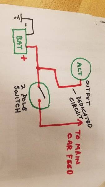

It makes no mention of switch direction. T 4 pole switch is the simplest method. Turn the field circuit off with the 2nd set of contacts. Or run a dedicated circuit from the alternator output to the positive post of the battery.

I don’t believe u can use a 4 pole switch anymore. Only allowed 1 wire/cable front to rear and 1 rear to front.I used to splice into a field wire and click the toggle switch off when going thru tech. Then back on when on the return road. Kim

Where did this come from? Section 8.4 Master Cutoff says nothing about this in the NHRA rule book. Mine is 4 pole. Been teched a bunch.

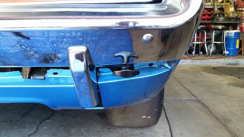

On the Charger, the push/pull rod goes through an existing hole in the bumper where a hitch used to bolt on.
In tech they wanted it marked. So took a sharpie and wrote "PUSH OFF" on the bumper. It passes tech.

They made me change mine to a 2 post. Told me u can’t have that many live wires running to the back.Car shuts off fine. Everything is dead when switch is flipped off. So it works how they want it. Kim
