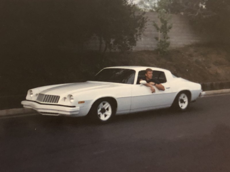

I had KYBs in this car:
Yeah...that was the late 80s. Stock leaf springs and station wagon front coils cut down. It rode okay but not great.

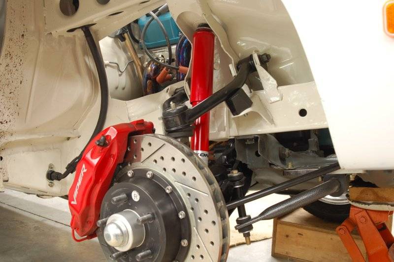

When I got this car together....
I went with 1.0 torsion bars and KYBs. The ride was stiff but I thought it was the thicker torsion bars that caused that.

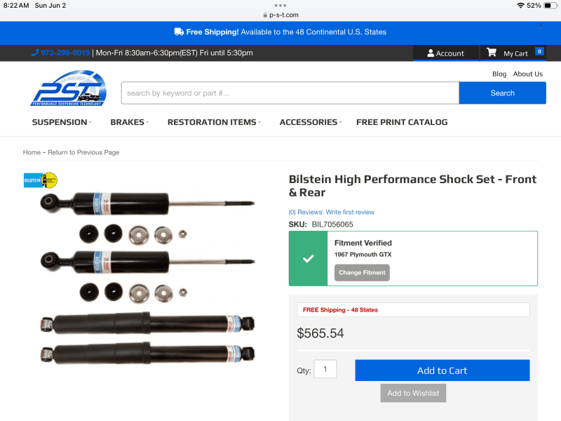

In 2014, I went with 1.15" torsion bars and Bilstein shocks. The car actually rides better with the bigger torsion bars and better shocks. All along, the shocks were the biggest factor in ride quality.
