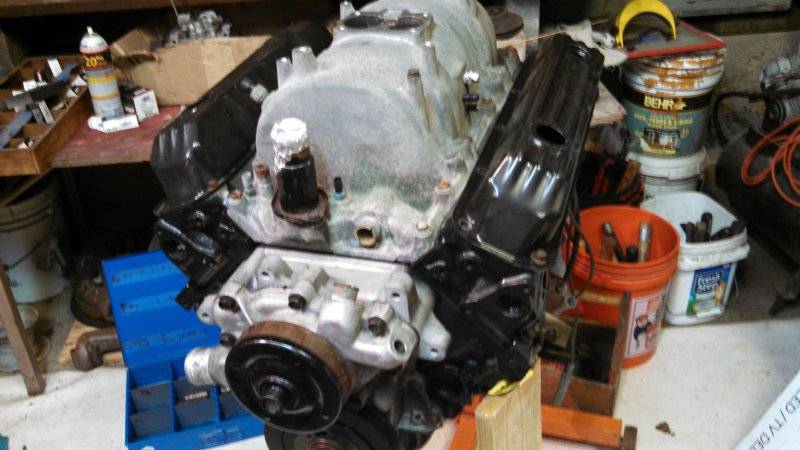

I currently have a 318 LA in my plymouth and I need to swap the engine because it's shot. I decided on a 360 magnum since they aren't hard to find and arent too expensive. I want to reuse the intake and carb on the 318 because those are fine. What would I need to do intake for it to fit a 360 magnum? It's a after market intake for a 318/360 LA. Is it also possible to use the headers off the 318 LA. I'm trying to save as much money as possible as I don't have much.

A 5.2 or 5.9 Magnum bolts vertically down whereas the LA is angled.

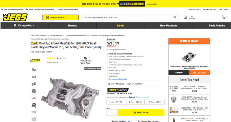

Hughes sells a 4bbl intake for the magnum made by Edelbrock but theyre not particularly cheap.
There is another one by Speedmaster that Jegs sells which has both bolt patterns

If you aren;t going to use the Magnum EFI set up just buy the edelbrock or that thing on Jegs(I hate Jegs though, china now)
Then it is a direct bolt on, no effing around required. Heck you can probably find one on ebay or facebook used for under 2 bills.

also,ive used those el cheapo 4v magnum chinesium intakes and they work just fine Except for one thing,if you have Ac the front water transfer nipple is totally wrong placement and will hit.
Sell the current intake you have now and roll the money over into a new intake. I suggest the Edelbrock RPM.
I’m have both the Edelbrock rpm and the Speedmaster chink knock off rpm intake. The chink intake is cheap and fine for stock to mild camshafts. I’ve used it with a mutha thumper cam. It was OK and fine.
I am using the Edelbrock RPM on a dead stock long block 5.9 right now and it is an excellent engine and feels better than the chink knock off intake that was on a hot rodded engine.
IMO, the Edelbrock is totally worth it.
If your running a mild cam (under 220@050) the chink intake is fine. After that, I’d be happy to pony up for a real RPM.
