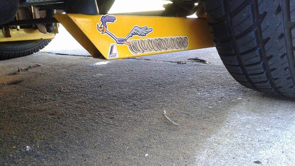

So all is well, but I had to leave at 2:30 to go pick up my wife when she got off work. My son and I got about five miles from the lake when I started hearing this scraping/grinding sound start to come and go. At first I thought I had blown a speaker, so I shut the radio off, but the noise was still there and started getting worse. It definitely sounded like metal to metal contact, but I didn't feel any feedback through the steering wheel and the car was tracking fine. I thought maybe the traction bars were rubbing one of the rear tires, but when I took my foot off the gas the car didn't decelerate abnormally. Then I thought it was the brakes, but the noise was there before, during, and after hitting the brakes so I ruled that out.
We stopped at an O'Reillys Auto Parts, and did some maneuvering through the parking lot, and found the sound worsened when turning to the right and lessened when turning to the left. The only thing I could think of was a bearing was starting to go bad or a rod end had slipped and was making contact with the hub. So we decided to go back to the house and swap cars instead of taking the Roadrunner back to the lake like we wanted.

Ooops... meant traction bar! :)

He wrote "Traction" bars.
I don't know why he has traction bars on a Mopar, but hey.... :poke:
He fixed it after I poked a little fun with him. Yes Mopars have pinion snubber that do the same thing but some just like that look, brings back memories I suppose?
Because they SCREAM 1970s. :)
