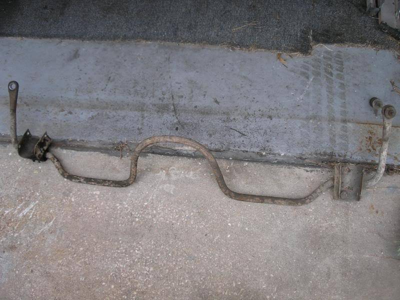

Dodge Dart with a rear sway bar off a Dippy cop car...
Rear sway bar of a Dippy cop car..

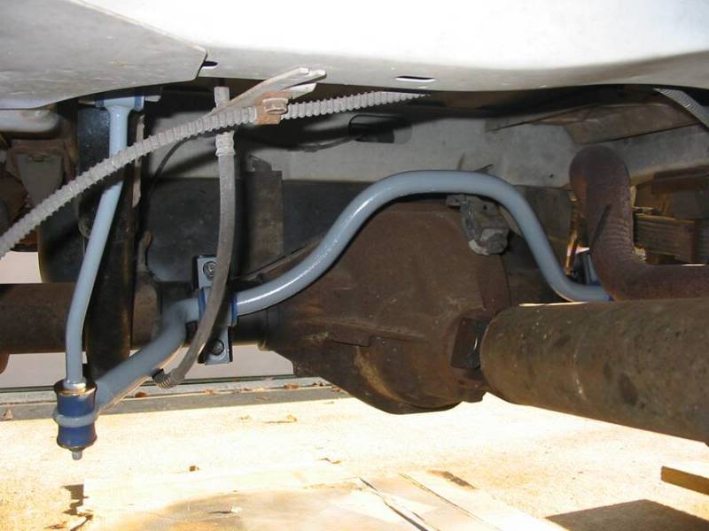

My brother put a 1 1/2 inch rear sway bar from a Ford Dually on his 1 ton Dodge van... huge difference

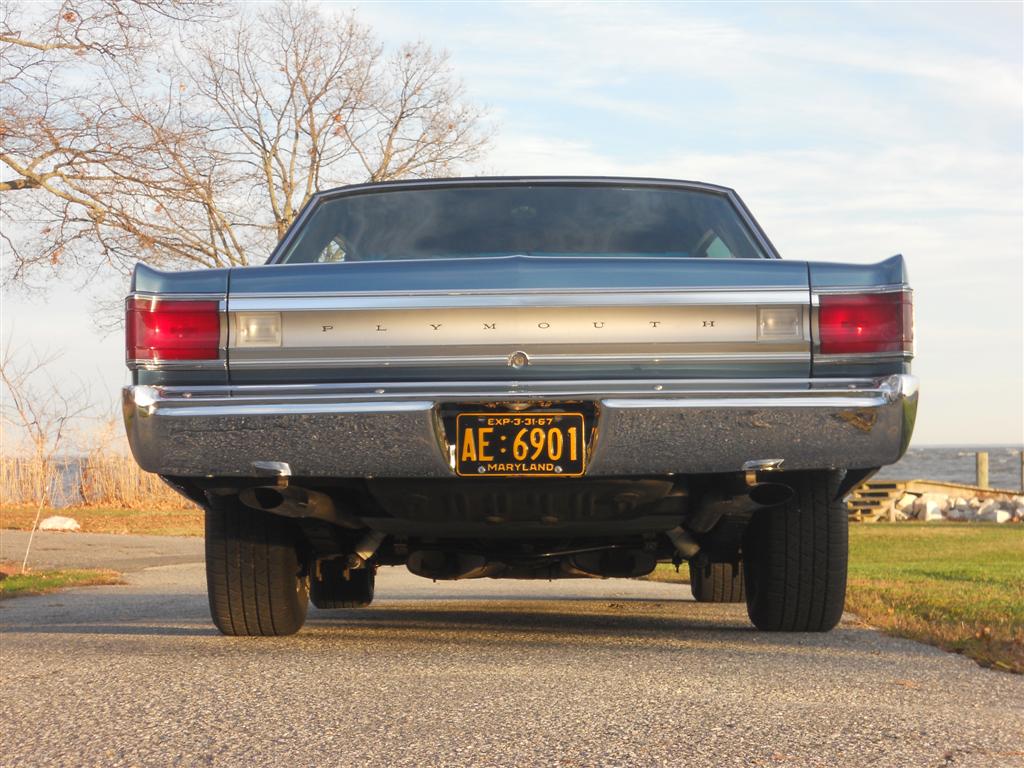

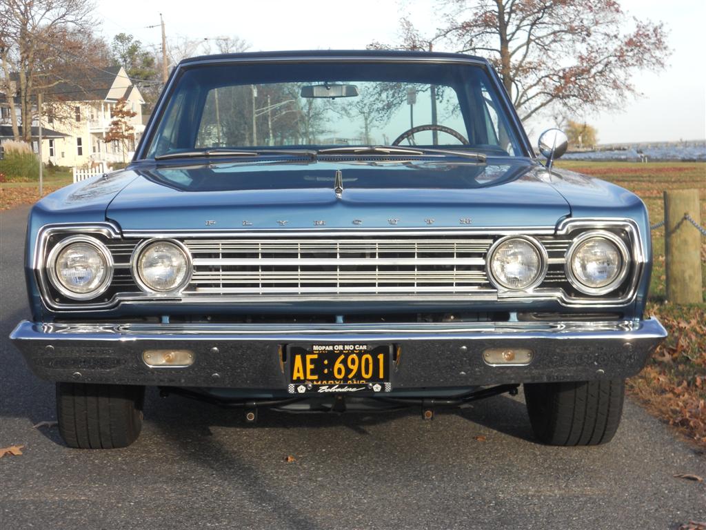

I have a '68 satellite and originally thought I didn't need a rear sway bar, so i just installed a 1-1/8" front bar from Hotchkis. The car felt like it suddenly developed understeer. So I finally added on a 3/4" rear bar from Firm Feel that looks very similar to the frame hung cop car rear sway shown in an earlier post. Now the understeer is gone and the car feels more balanced. I haven't pushed the car hard in corners yet. I'm glad I added the rear sway bar.
